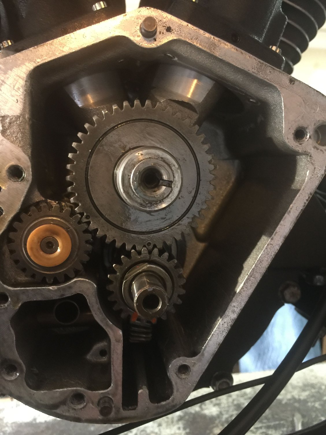

What am I doing wrong I even tried it without a shim as soon as I tightenthe cover everything locks up the flat part of the thrust washer is facing the top rear of the engine it's all put together right

Did you swap the gear from your old cam onto your new one?

No it came with one but with the cover on just snug it turns freely as soon as I tighten it all the way down it locks up
I swap the oil gear to a metal one do you still use that washer on the end with it

I put the plastic gear in and it turned smoothly not sure what's wrong with the metal one

The breather should have come with new metal washers. When I put the wrong washer on my breather it did the same thing as yours and nothing would turn when torqued down.

There is a tolerance for the breather gear as well, lay a straight edge across the cam chest and put a feeler guage between the straight edge and the washer(shim). I can't remember the measurement tho and I'm at work, someone will chime in if I don't get it for you later.
