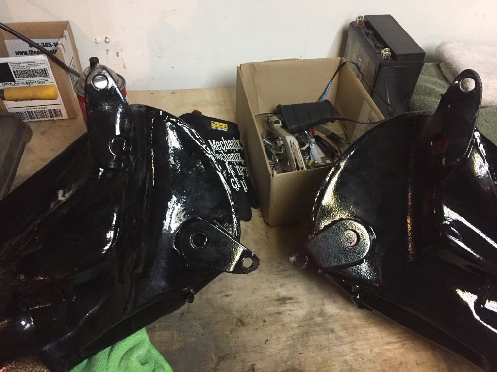

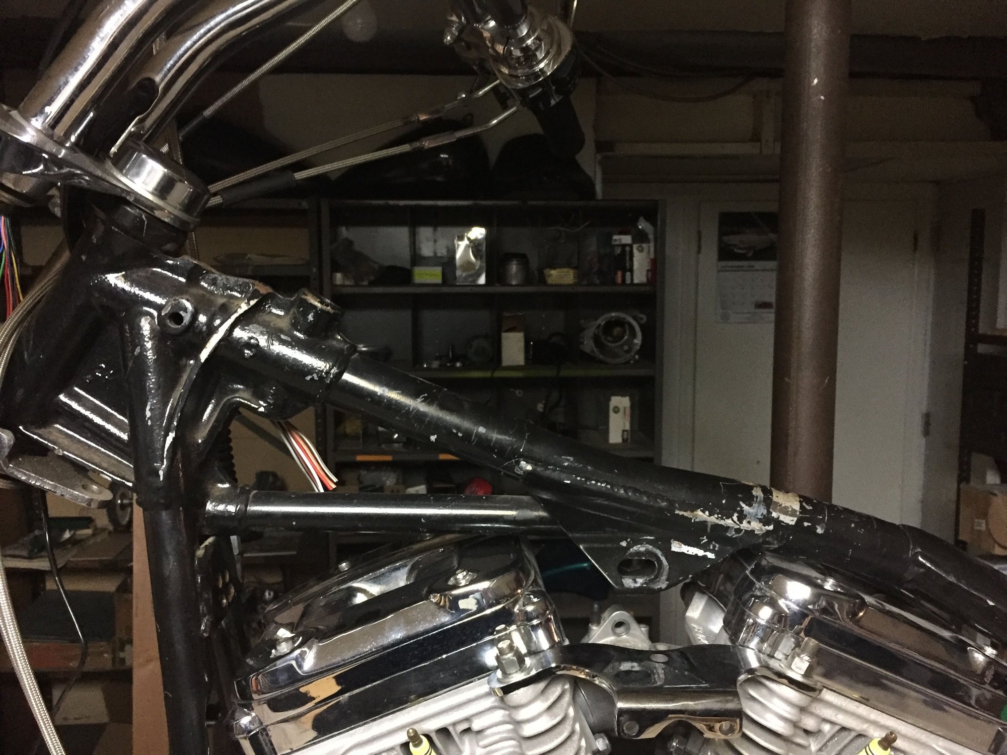

1. The gas tank.
The seller did not have a tank mounted on the bike, but had a set of split tanks that he "painted" (horribly) in a box that he gave me. I can't tell how they are supposed to mount up to the bike - of even if they are the right style. Here are some pics of the neck of the bike and the tanks:
Any idea how these are supposed to mount, or if they are even correct?

Tanks mount to brackets that bolt to the frame...mine are chrome and marked with arrows...kinda looks like some of the mounts have been cut off that frame.
Probably going to need a "framesaver" mount.
Those are shovelhead tanks..you could use them if you bought the correct mounts...but the rubber mounted softail tanks are a better design.
https://www.yalesmotorcycleparts.com...nk-mount-kit-3
This is really helpful - do/anyone you happen to have any more pics of how that bracket mounts to the frame? Trying to see if I do in fact need the framesaver, or I've still got the mounting points for that bracket. I do have a flatside tank mounting kit that's been sitting on the shelf.

It there another round stanchion that fits in the fwd receptacle on the frame for bracket 31 to wrap around? SGR60, I have a 1984 Softail manual on my laptop with me if you need something till you get yours... Does a 84 Shovelhead have a under spring like a softail? It shows a similar tank like mentioned above.

Hard to tell from the parts diagram where that's supposed to mount. Is the red arrow in Tom84FXST's photo pointing to it?
If so, it looks like that may have been ground down on my frame, looking at the side shot photo. So if that's the case, I'm thinking I may have to grind everything down and install the frame saver?
EDIT: Also, one other question on this. Does that dash mount right to the frame, or is there another intermediate bracket? Hard to tell. What about that vertical silver colored bracket that has the circuit breakers on it - is that a needed OEM piece?
