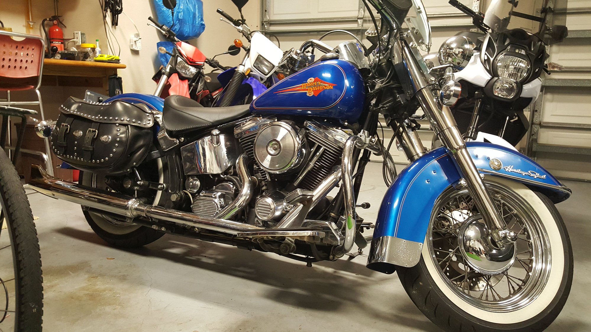

This is what she looks like. Floorboard measurement is similar. Left front corner 13 inches. Right front corner 7 inches when on side stand.

Then the only thing I can tell you is slow down.
Softails aren't sport bikes.
If I remember right a softail has a 24° lean angle and a bagger has a 37° lean angle.
FXR's and sportsters will have even more.
I came to harleys off a VTX 1300 and that thing has even less of a lean angle than the softails so I'm good.
You may end up deciding that you need more lean angle for your riding and to be honest you will have to get a different style of bike for that.
