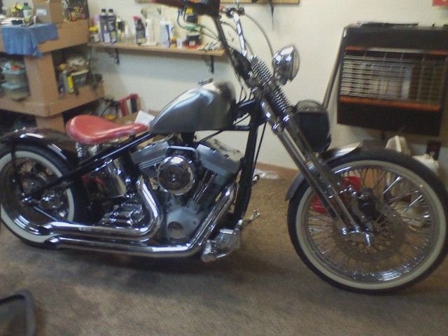

Highly possible since I'm working on two bikes at the same time. Been working on my bobber, changing the bars, adding a small front fender, larger gas tank and general maintenance. With this one apart, the charging system on my Ultra took a dump. Had to have something to ride so, while waiting on parts, I slammed the bobber back together temporally. This is what it looks like right now.
