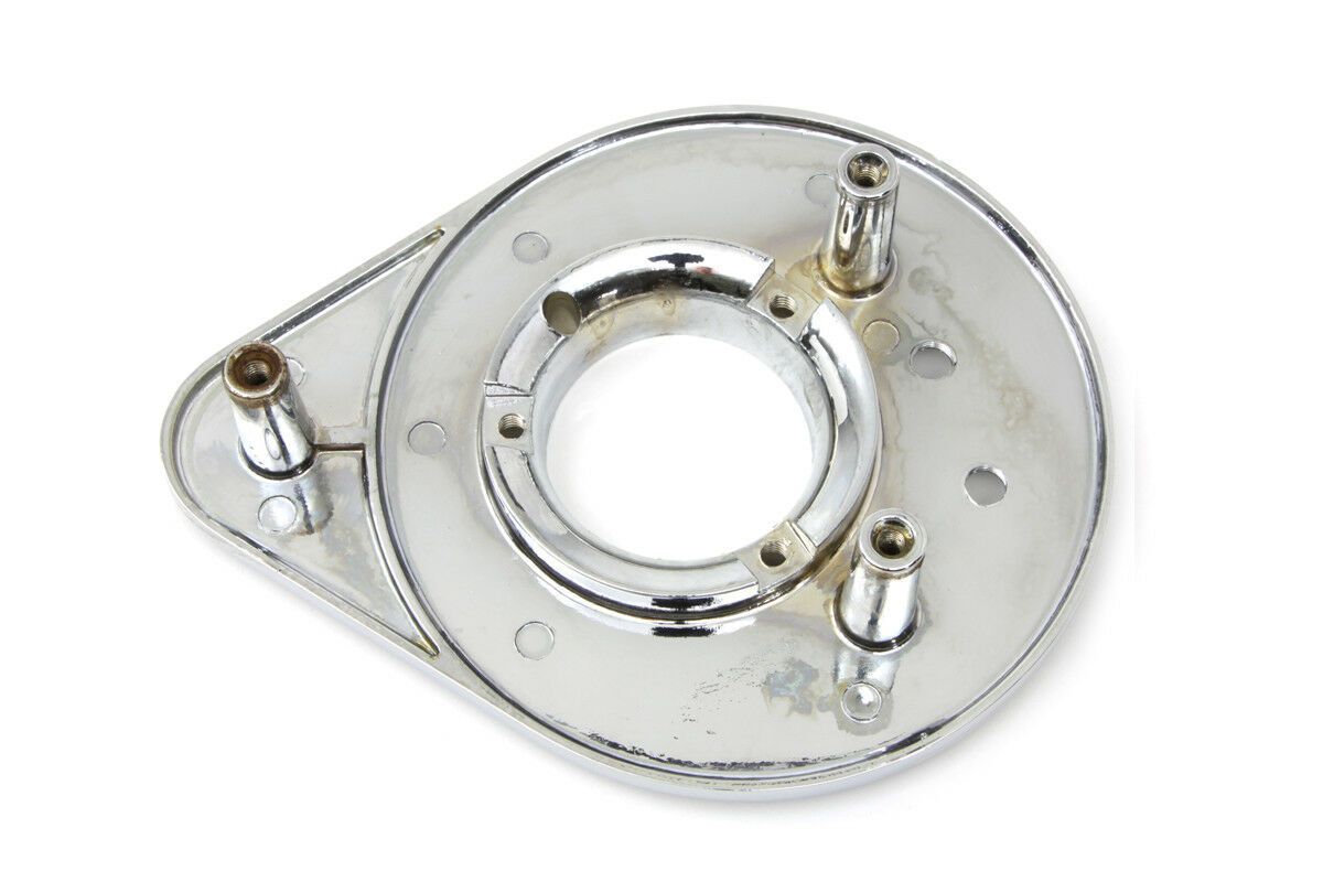

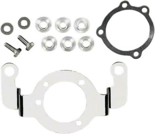

I put a CV on my 85 FXRC I used this,
DS Air Cleaner Support Bracket for CV/Delphi Chrome Harley Davidson #139370, but I used an S&S tear drop filter and cover so I used this backing plate V-Twin 34-1389 - Chrome Alloy Air Cleaner Backing Plate, worked perfect

For a bottom breather Evo, all you need are some 5/16"-18 bolts of the correct length, depending on which backing plate you've got.
I went all around the barn when I put a Big Sucker on my '90, imagining all sorts of nifty things I was going to have to do to mate the backing plate to the heads. In the end, a couple of the above bolts, a handful of 5/16" washers to shim the gap, and that was that.
