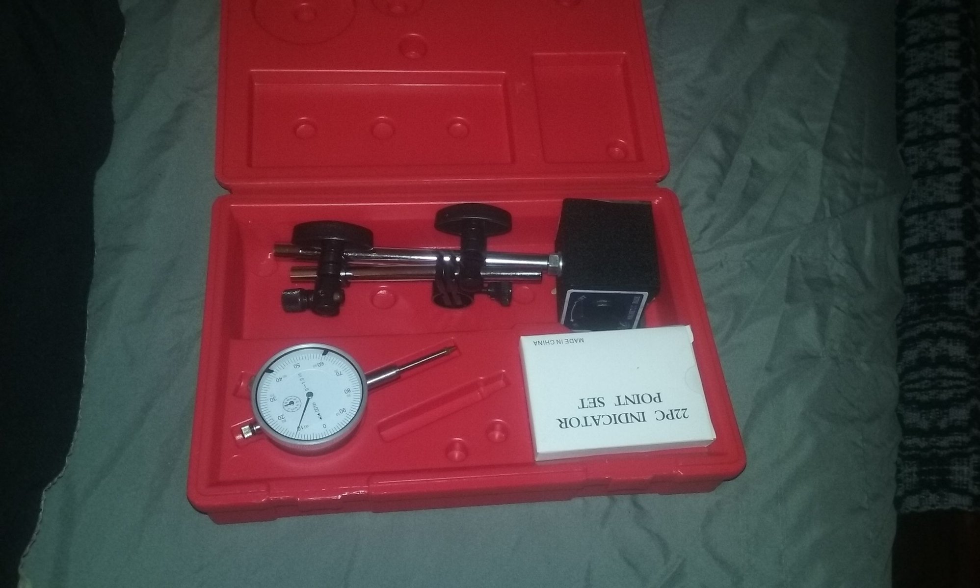

I bought what I needed to check my end play however when I went to put it up on my motorcycle jack the bottle jack had nothing left to give. I wasted about three hours of my time/a bottle of fluid taking it apart, cleaning it, and refreshing the seals. It didn't return to its former glory so now it is the base/weight with weels keeping my bandsaw upright and mobile. Twenty something years as a motorcycle jack.... It was time for a demotion. We never worked well together anayway.

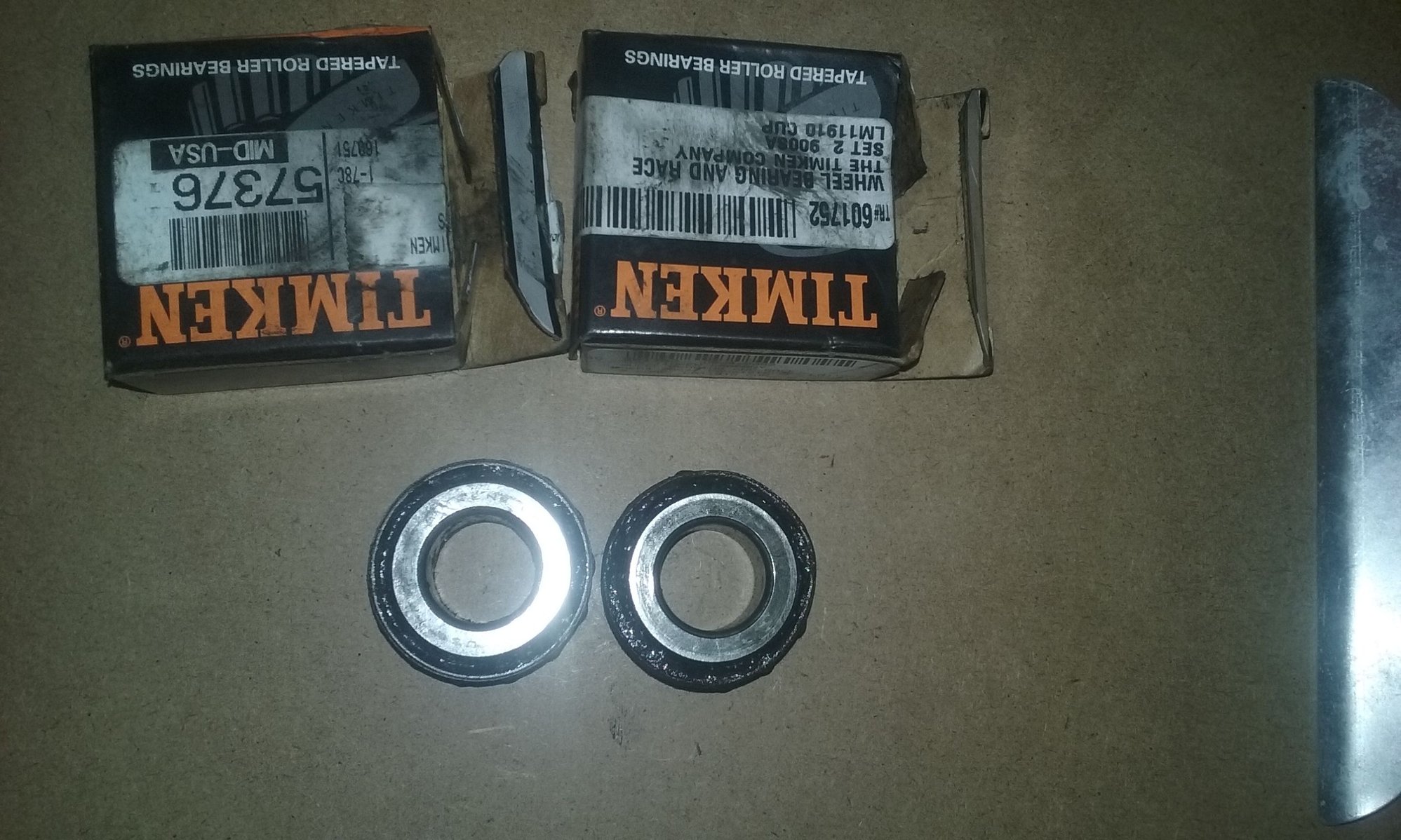

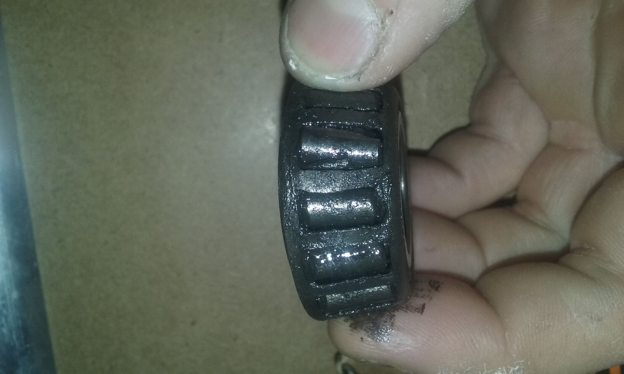

They replaced my wheel bearings because the old ones were SMOKED!!! You guys probably already figured that out frm the picture.

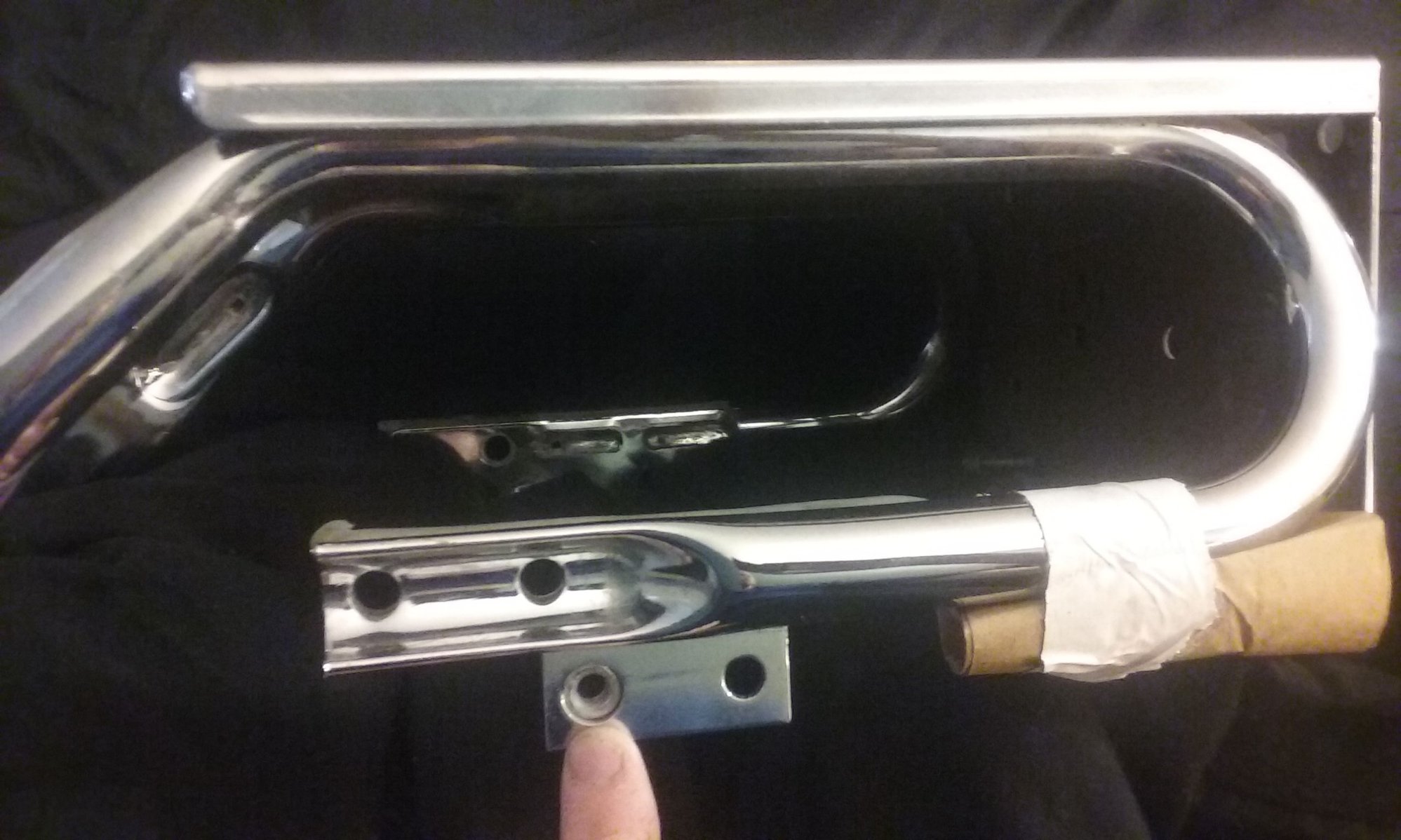

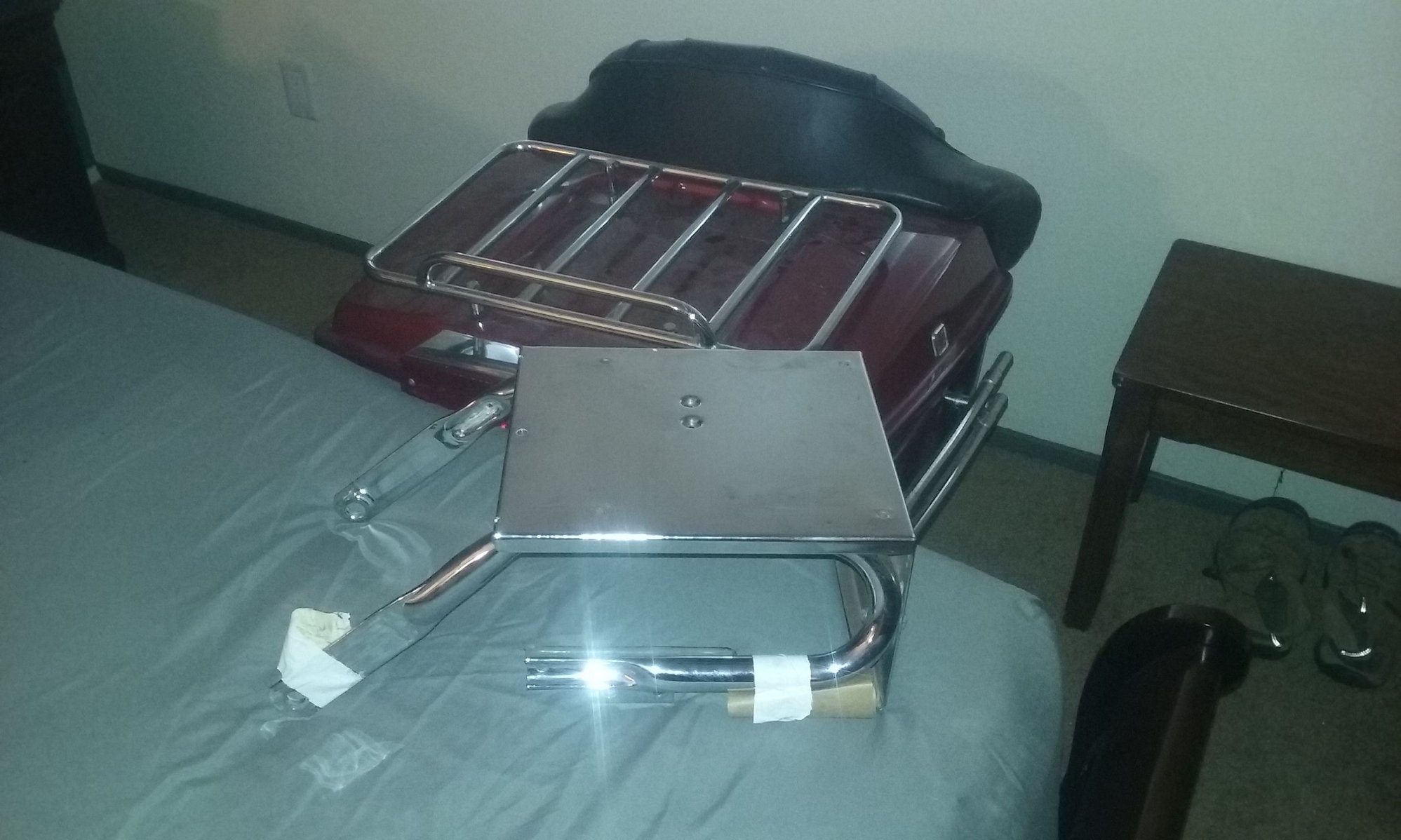

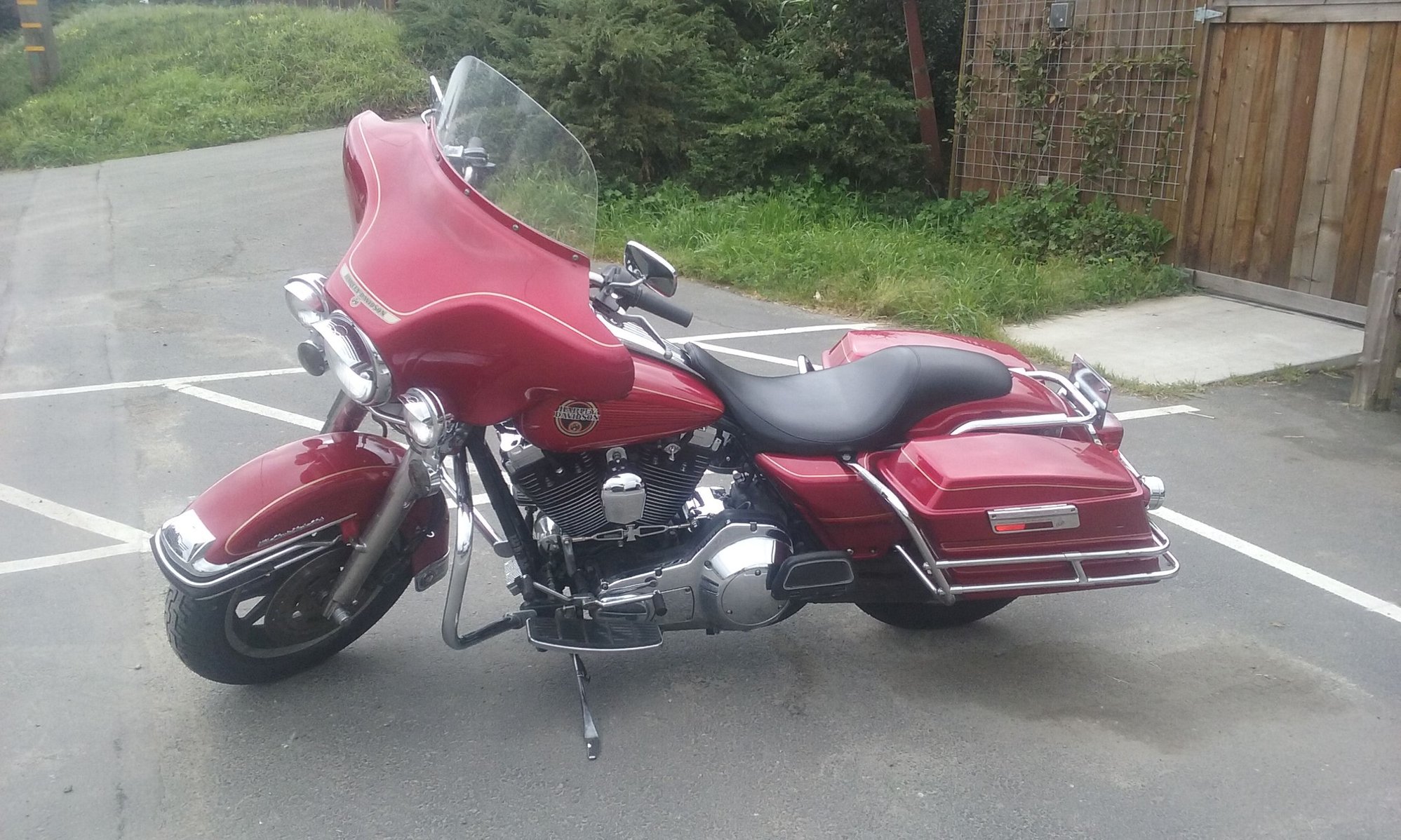

JMB19 What you want are Harley dealer part #s53376-97 and 53422-97 to get rid of the tour pack. Around $100 and you will have to adjust because the mounting nut that I'm pointing to is on the other hole if I remember correctly. Its an easy mod though. My seat is a LE PERA SMOOTH FULL LENGTH LPL-867. I paid around $300 for it and just incase you were wondering my dash is not correct for the bike. Thats why the seat overlaps it. Couldn't stand the CB dash. Your back fender should already have the bolt hole for the seat. If you need some more detailed pics let me know and I will do my best to get them.
