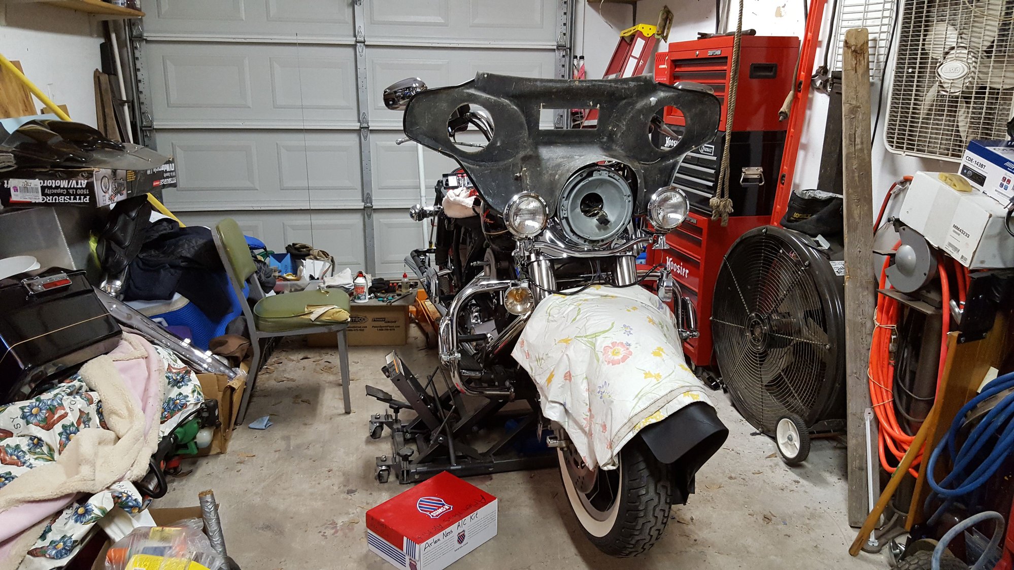

Still in pieces. Found some more **** to address. Installing more new stuff. Riding in a couple weeks.
