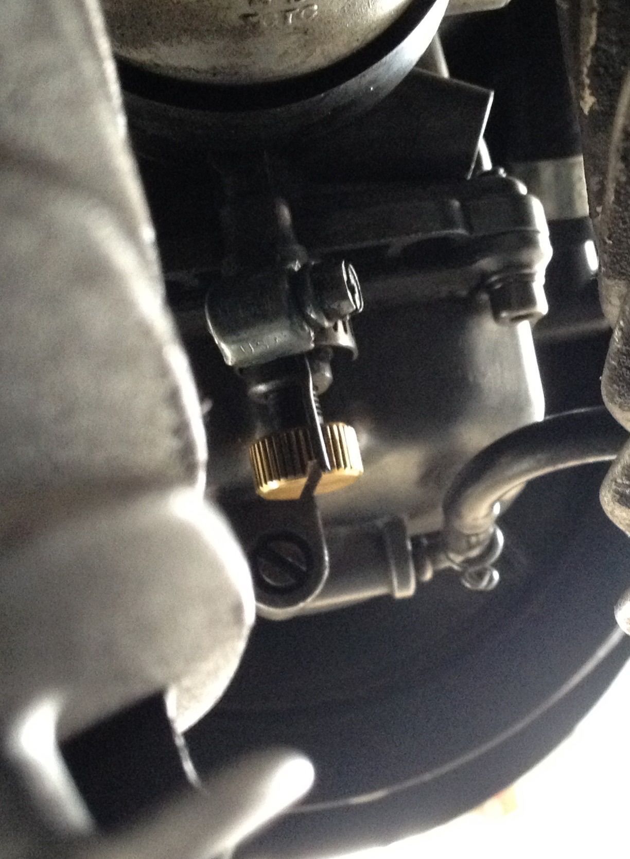

Originally Posted by kp877
Finally road tested with aces&8s ignition module and it's like a different bike. Pulled hard til 5500 easily. No drop at 4500 at all. So my cam sensor plate was faulty but it didnt fail like most.
New problem. My ezjust mixture screw fell out 10 minutes into the ride.
Get a paper clip and a screw clamp for your next EZjust.

That's a clever idea, maybe I will buy another one if I know it won't fall out. I can't find mine, as crazy as it sounds I did try and find mine, I pulled over when it started backfiring out the exhaust, but it was already gone. Drove the road twice thinking a shiny brass piece would stick out on a sunny day but no luck
