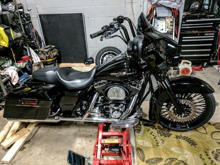

sorry for posting on the from forum but didnt know where to start with this. i was away all week so im going to dig in this week and figure it out, to answer some questions the bike has 43000km and i bought it from the Harley dealer in January. i also have a 1 year warranty with it so wondering if i should even get my hands dirty. but i am also good with motors but never worked on a Harley.. heres a pic of her. i blacked everything and did all the custom work. the bike was stock when i got it. the motor is still stock.
