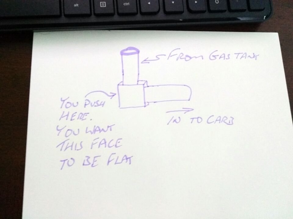

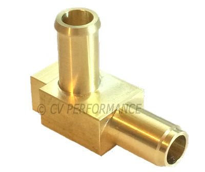

There are a couple of styles of replacement nipples out there.
On some (the kind I'd say you want), the surface you will be pressing on to press the nipple into the body of the carb is flat, giving you an easy surface to push on. Like this:
On others, that surface has something of a triangular cross section, making pressing it in a bit more of a fiddle.

So there's a drag specialty one, that's the only one I could find when mine was apart. It's a corner right where you want to press and it's hard to get it to go in straight. There's another version that's flat. It would have been much easier to get this one in. It's not impossible obviously but if you have the choice go flat it will save you some cursing. Here's some pics of what I mean

The elbow from CVP has a flat surface for pressing it in.

The HD part number for the brass replacement fuel inlet L-joint is 27371-76A and it cost me about $11 back in 2013. I pulled the old one out using a 1/4" bolt threaded into the old fitting along with a nut and socket. There was a video showing that trick that I had watched. I put the new fitting in the freezer and then pressed it in using a vise. I had my doubts about doing this replacement but everything worked smoothly and it never leaked.
