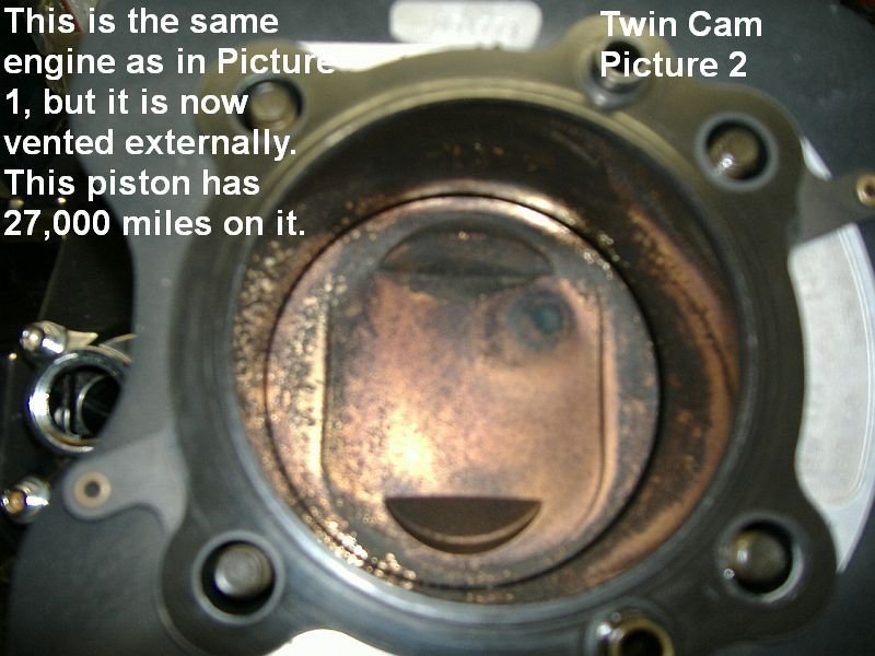

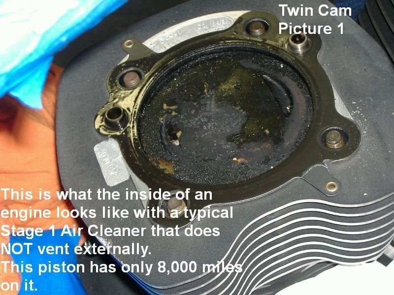

Aces I found those pictures I was telling you about.

Obviously engine,I mean motors don't run as clean running a factory pcv system,they want to protect the atmosphere not the motor,lol, two things are clear in the picture,way too much oil in the vent system and definitely not the same piston,lol they should at least use a piston with the same valve relief in them.
Texas,I'm not saying don't run to atmosphere!!!! He probably should....with an oil collector vent system.
