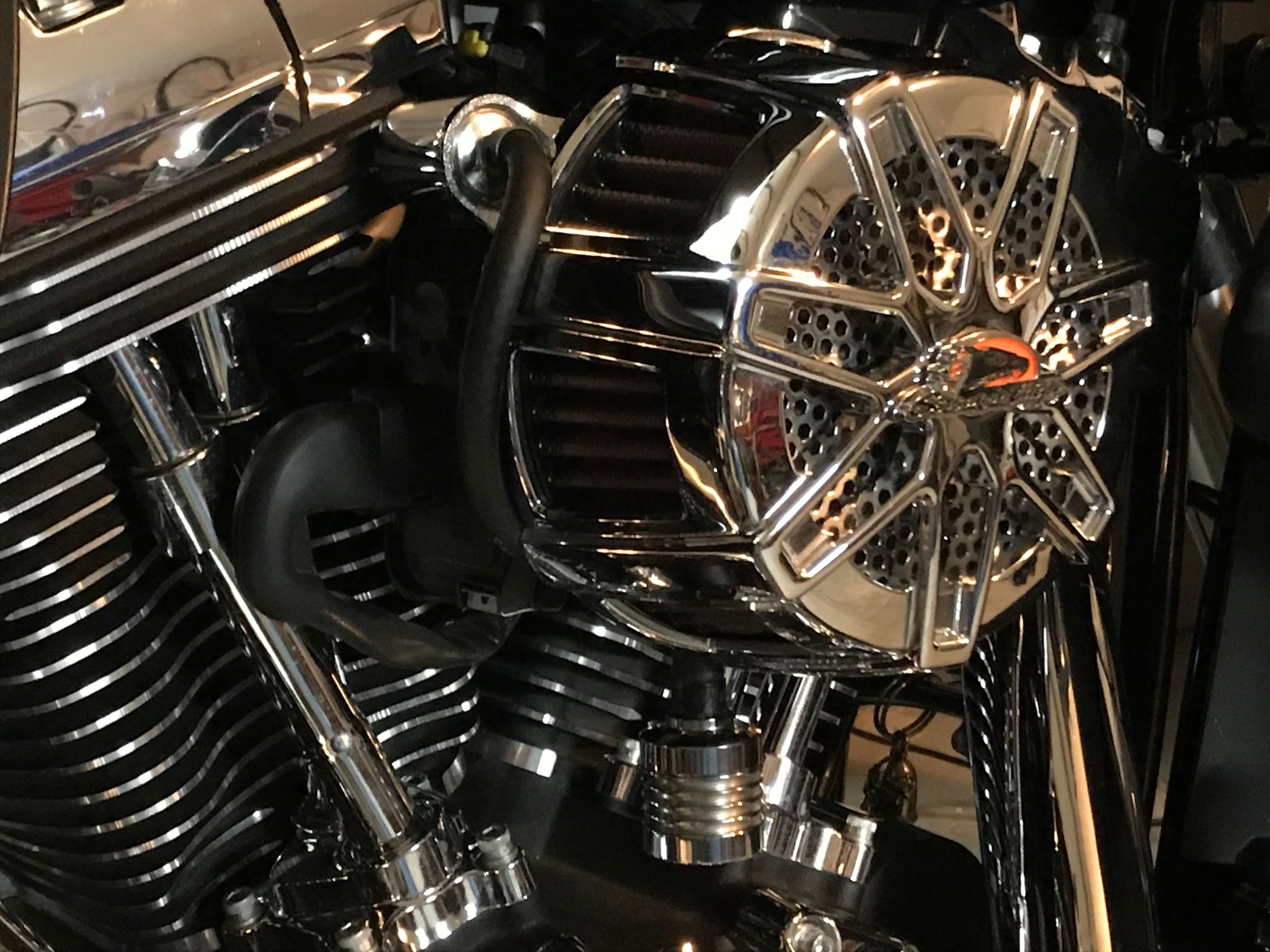

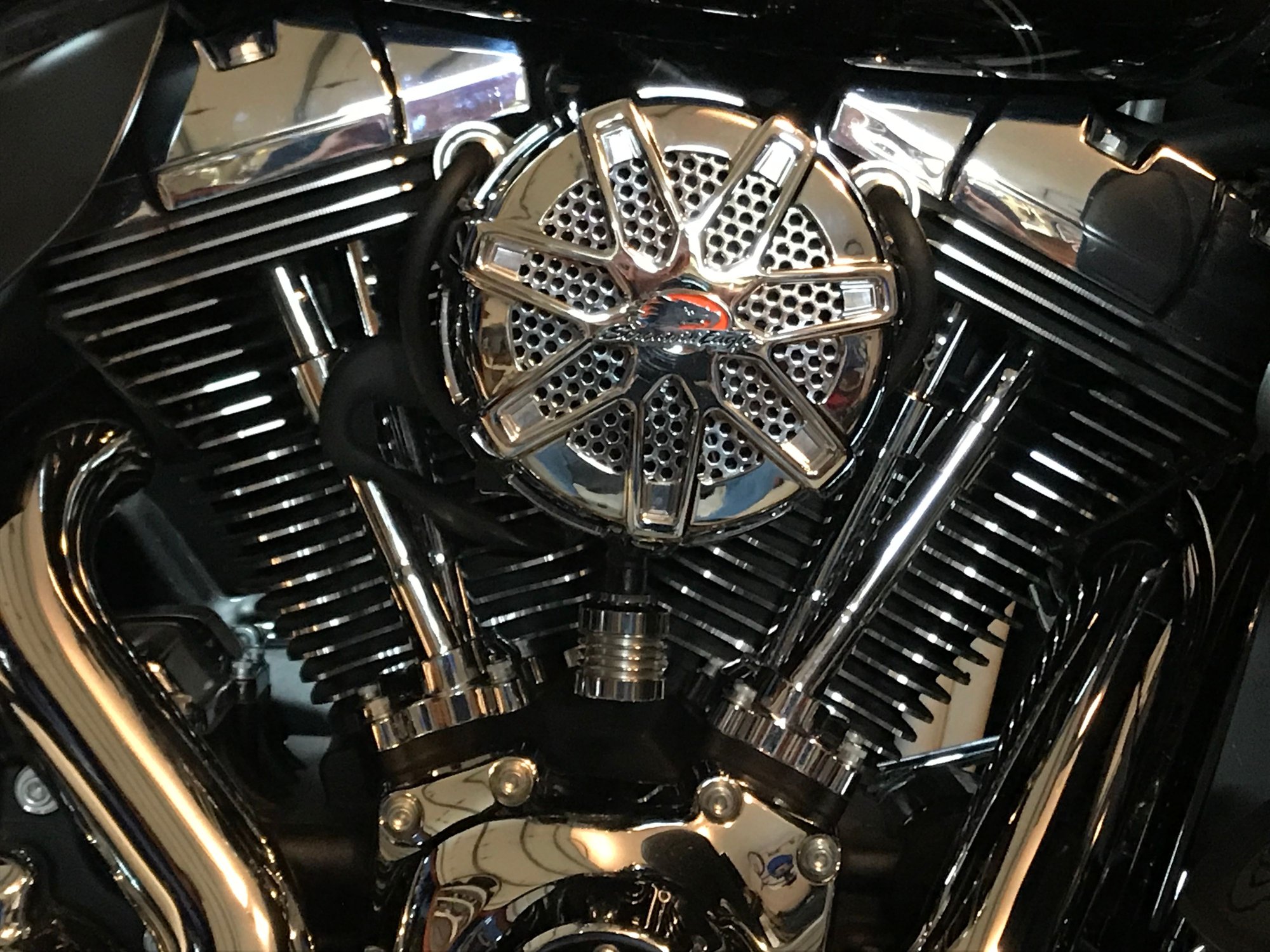

Check out these pics:
You can see that even if you chose to just run the line under the bike, venting externally is definitely something you'll want to do.
Here's a pic of our Twin Cam Discrete kit:
Here's a LINK if you'd like to check it out.
