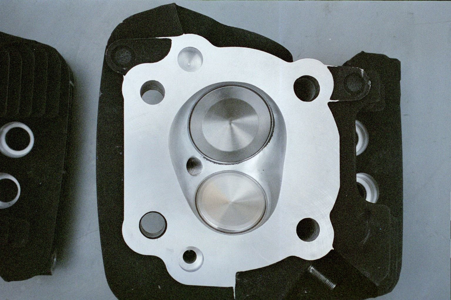

Any one have actual stats on the SE heads, like port diameters, valve size and chamber cc's. What makes them better than stockers. also if you have a pic of the combustion chambers, I'd love to see it....
Here's a picture of the SE heads on my 93 incher. Reworked by Paul Hannan, but this will give you a basic idea about the shape of the combustion chamber.
