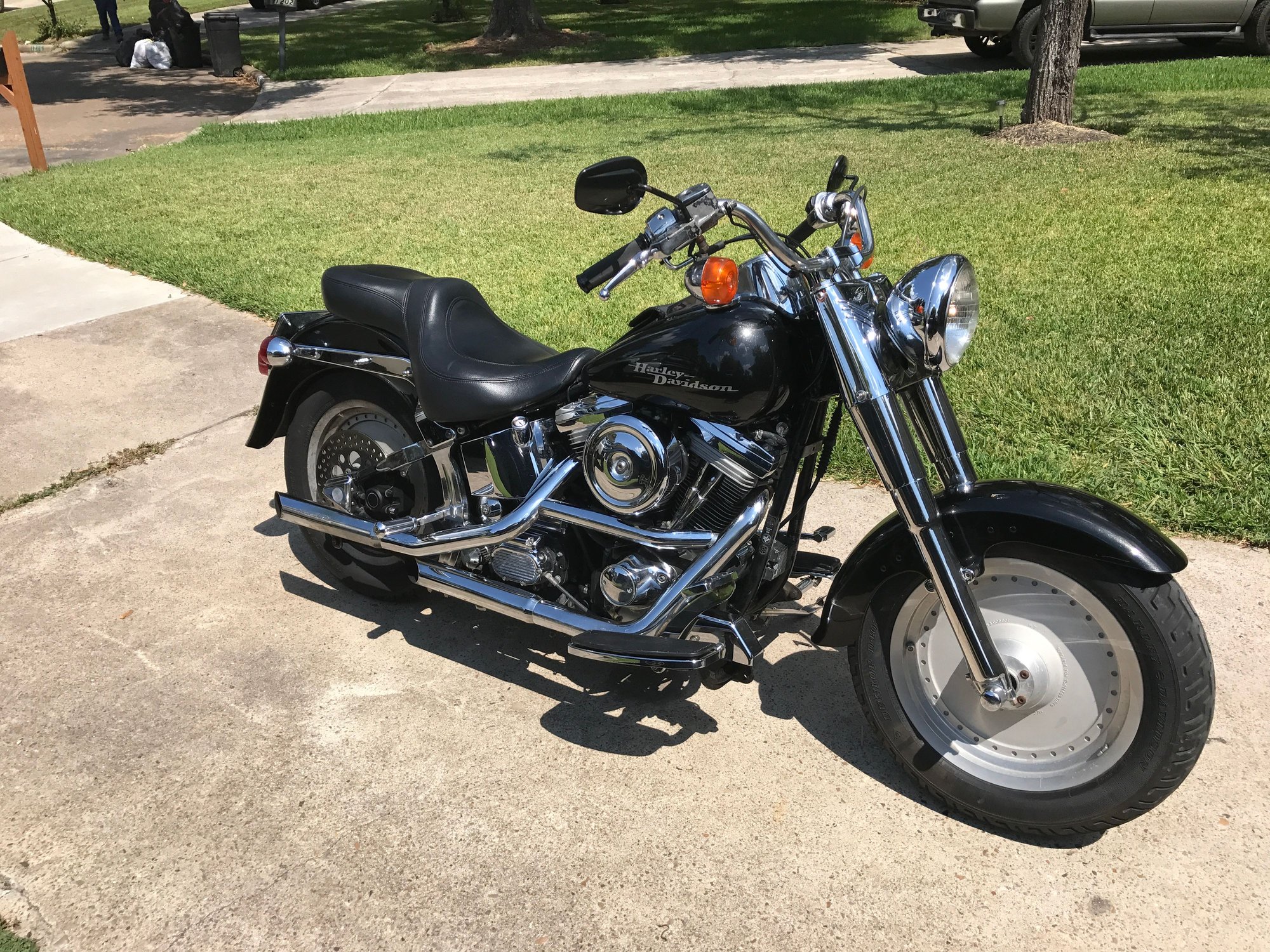

Hello all. I'm proud to say I found what I've been searching for. I purchased a 1997 Fatboy yesterday. I am absolutely in love with the sound of the EVO motor and the classic look of the bike. Having owned 2011 and newer Harley's I have a few questions about this particular bike. The gas tank is 2 pieces? So do I need to put gas in both sides or will that hose allow them to equalize quick enough while filling up? How low of an idle is safe with the EVO? Also there's a screaming eagle box mounted under the seat. I don't see a part number on it. Any idea what it could be? I keep reading not to let it idle too low. But it sounds soooo coooool. Is there anything to look out for with these motors? It has about 65000 miles on it and runs great. Rode about 200 miles yesterday. Engine barely got hot enough to where I could actually still set my hand on the valve cover for a few seconds. My 103 with cams and dyno tune gets waaaay hotter. (Different motor I know). Anywho just wanted to share the news and ask a few questions. Thanks in advance.
