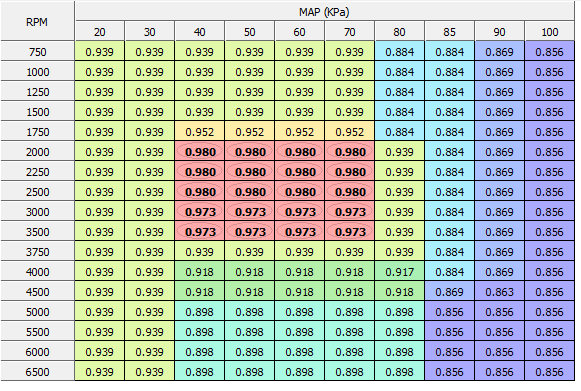

When working with afr, it depends on what fuel is run to what stoich is
for reference, my Twinky 110, SS585, 210ccp AFR map
straight gas
the same map for e10
but it's a Lambda based cal, stoich for any fuel is 1.00, same map

Originally Posted by 1997bagger
At 260 ccp you don't have a normal engine, you have a pressure cooker. Can't think normal jetting on this one, she is going to be touchy especially on a throttle roll on. Get it safe.
Tried to think normal jetting for afr's with the 130" in the White Bike, it did not like a traditional cruise 13.8-14.0 or 13.2 WOT (detonation) pulled it back to 13.2 cruise and 12.8 WOT and has been reliable going on it's 4th season. Sometimes the normal book is thrown out the window with a not normal Evo.
Good points, thanks. BTW, I fixed the high CCP issue. I never preloaded the damn intake pushrod on the rear cylinder Now they both (or, were) very even at around 210. Even with the scuffed cylinder, they were still both around 210.
straight gas
All true and good reference, but Twinkies got oil squirters, which will keep the piston cooler at any AFR than Evos. That certainly helps.
