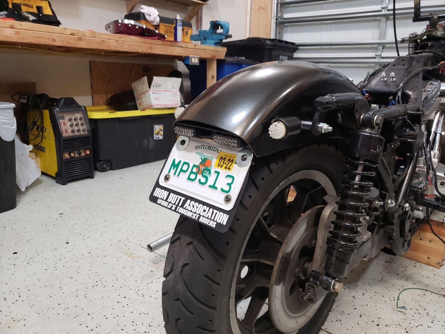

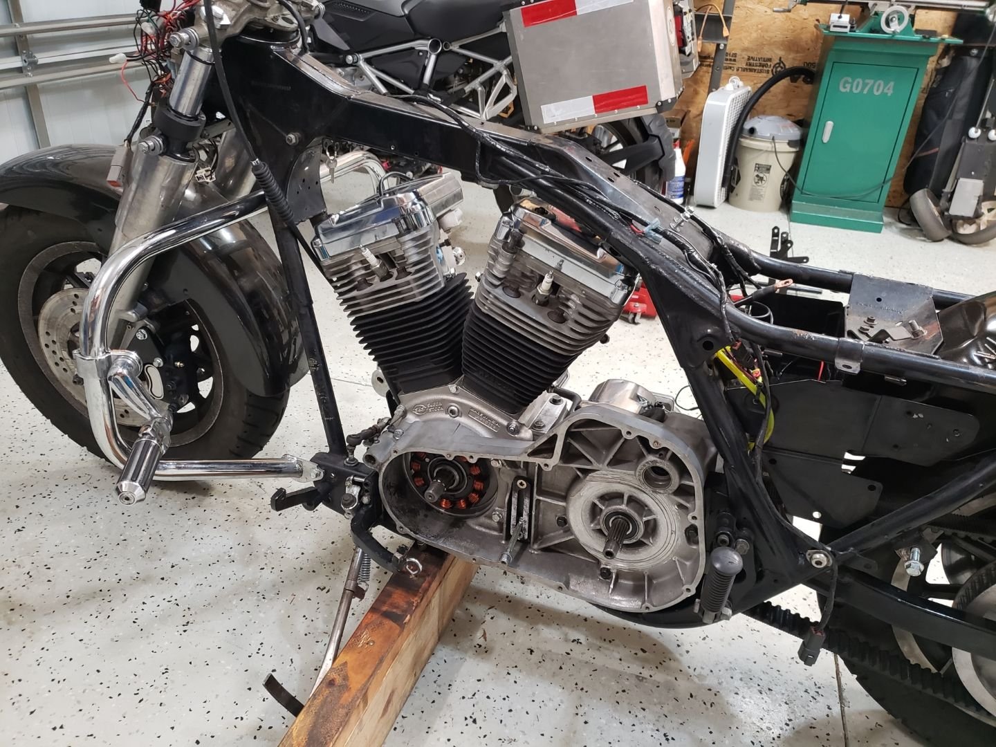

FYI, got the job so I've been busy lately but I'm also slowly plugging away at getting this thing back on two. Evo engine and trans back in:
Cleaned up the fender some more and made a new license plate/turn signal bracket out of aluminum using my new AlphaTig 201DX TIG welder:
The LED lights on the sides of the fender are just ON and Brake, and the LED strips above the license plate are FLASH for 3 seconds in the middle 8 and Turn on the outer 8 of each bank. They're Hyperlites brand.

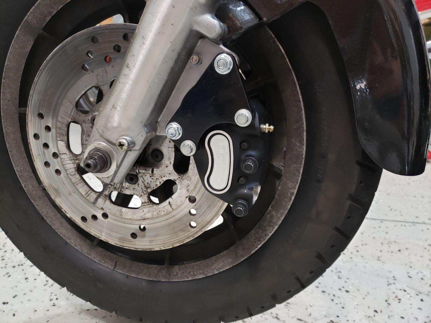

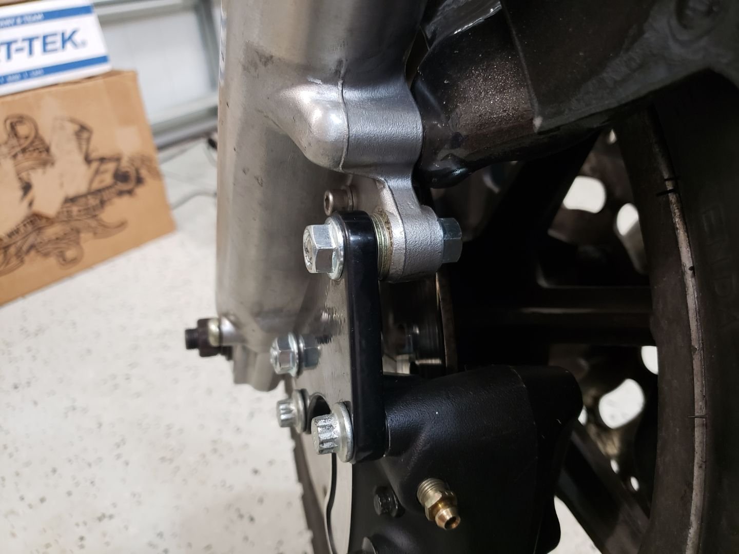

And I got those caliper adapters mounted up nicely:
Three washers needed to center the caliper on the rotor (as close as I gave a **** about getting it).
