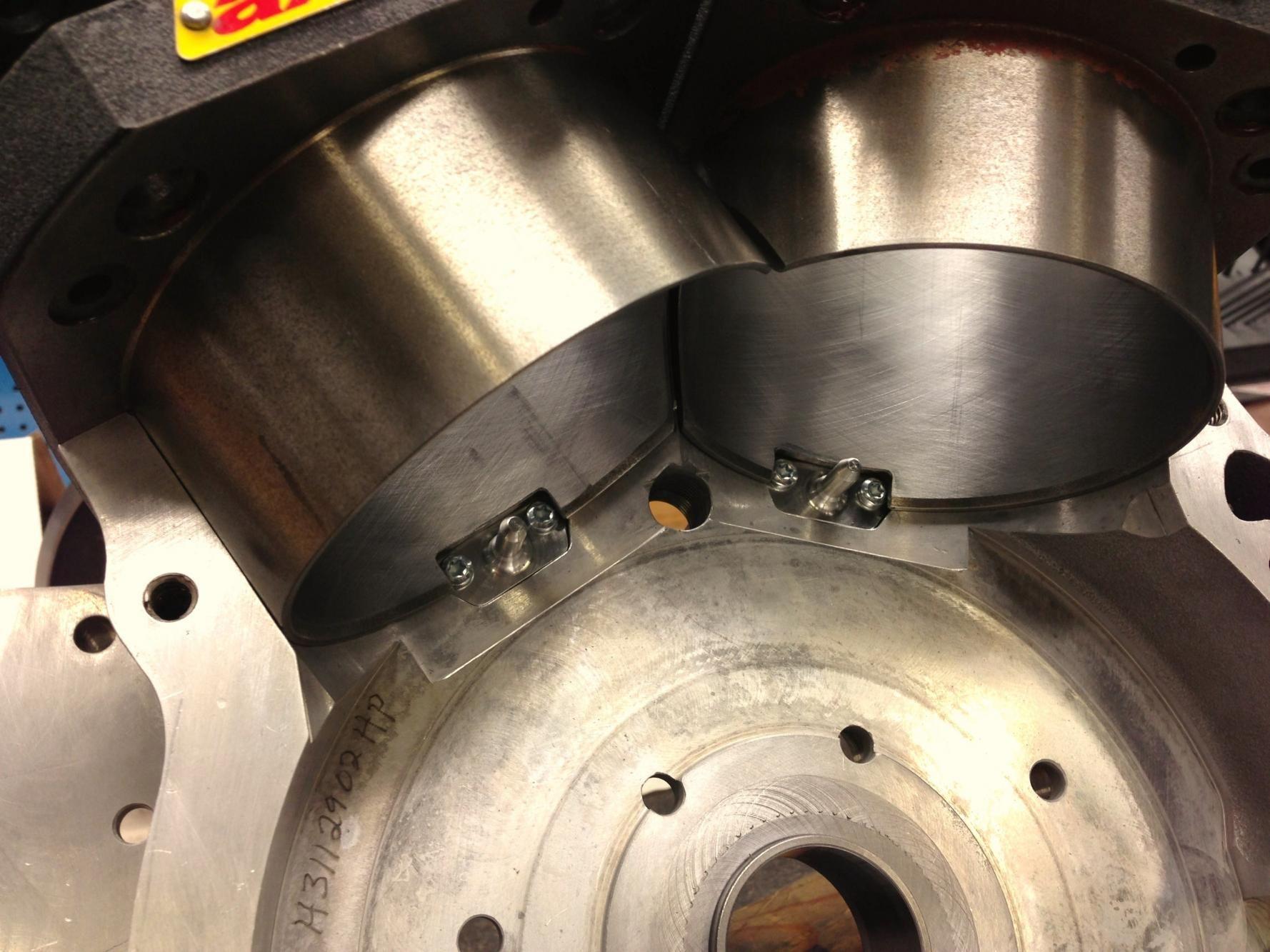

Sooooooooooooooooo................................ ............................. she popped again. (FYI, this is gonna be a long, technical post)
A couple weekends ago I wanted to head out on the interstate for a few miles. Mind you I'm at 220 miles so far on the build and have already put short interstate jaunts of about 25 miles on the bike with success. This time it was 40 out and 40 back. Temps were nice, low 80's. Keeping a constant cruise of between 70 and 75, RPM's never over 3000, AFR's never went over 14:1, CHT's never above 260F (I had a tail wind for the ride north, they dropped under 240 on the way back), and EGT's around 1450F. The whole way up only one weird thing happened. The bike had a quick hesitation, like a missed spark, then back to normal. The way back seemed fine as well but when I went to pass a semi I noticed the bike sounded weird as I accelerated to go around. It sounded as if I could hear excessive blow by going out the breather tube. When I got to the first stop light that's when the knocking started. Clear as crystal, KNOCK KNOCK KNOCK at idle only like there's a little guy with a hammer in the cylinder trying to get out.
First thing I did was have a chat with the wife. Without going down that road in this thread, I'm buying a 19 EGS soon after we close on our house in April. I need something reliable. I like going with my dad on rides and I've missed so many rides last fall and this spring it's starting to really bum me out. He's getting old and I want to spend as much time with him as I can.
The next thing I did was really think about the issue and what's causing this. The only thing I can think of, since it's commonly the front cylinder with the most damage, it lack of oil being slung onto the bottom of the piston from the crankshaft. If you think about it, as the crank is spinning it collects oil at the bottom of the case, then whips oil into the cylinders as it makes the pass around. The bulk of the oil hits the rear cylinder. This would explain three things:
1. Why the large bore S&S motors come with piston oil squirters
2. Why the Twin Cam comes with piston oil squirters
3. Why the rear cylinder is always running cooler than the front.
This piston oil squirter thing has been at the back of my mind for some time now, although it doesn't explain how S&S was capable of marketing the 96" (which is tightly based on my build only smaller with aluminum cylinders). It could also shed light as to why S&S stopped at 96". Maybe they tried the 106" but kept scuffing pistons like I am. Ultimately, someone from S&S would have to answer that question.
In my research I discovered someone on the XL forum who was having the exact same issue on his S&S 100" Sportster build only he was on his 6th set of pistons/cylinders. At the end of his thread he shows a pic of piston oil jets he's had machined into his crankcase with notches in the cylinder skirts:
Also within that thread is a person who has a LOT of Big Bore Shovel head experience with the same experience both of us have, as well as the same root cause analysis as to why it's happening (lack of oil hitting piston to cool crown). If anyone wants to read that thread:
http://xlforum.net/forums/showthread.php?t=1487546
Read post #24 for an elaborate theory as to why this happens.
Anyway, I've done a lot of research into this modification and I'm going to pursue it. Piston oilers are available from S&S for about $50, and I've recently purchased a Grizzly mill that's a bit larger than that shitty Harbor Freight one I used on my heads. The only difference I'll make is mine will point into the bottom of the piston domes. The ones in the pic above may help but the oil jet will be hitting the wrist pin the way it's currently pointed. Once we move into the new house I'll dive into the motor and start making chips. I'll also be sourcing new pistons/cylinders but I think I'm going back to the original build thesis of 30 degree domed pistons with the S&S 585 cam. There's just something about the satisfaction of meeting my intended goal, I'm hell bent on attaining it.
Thanks for listening, whoever still is.
