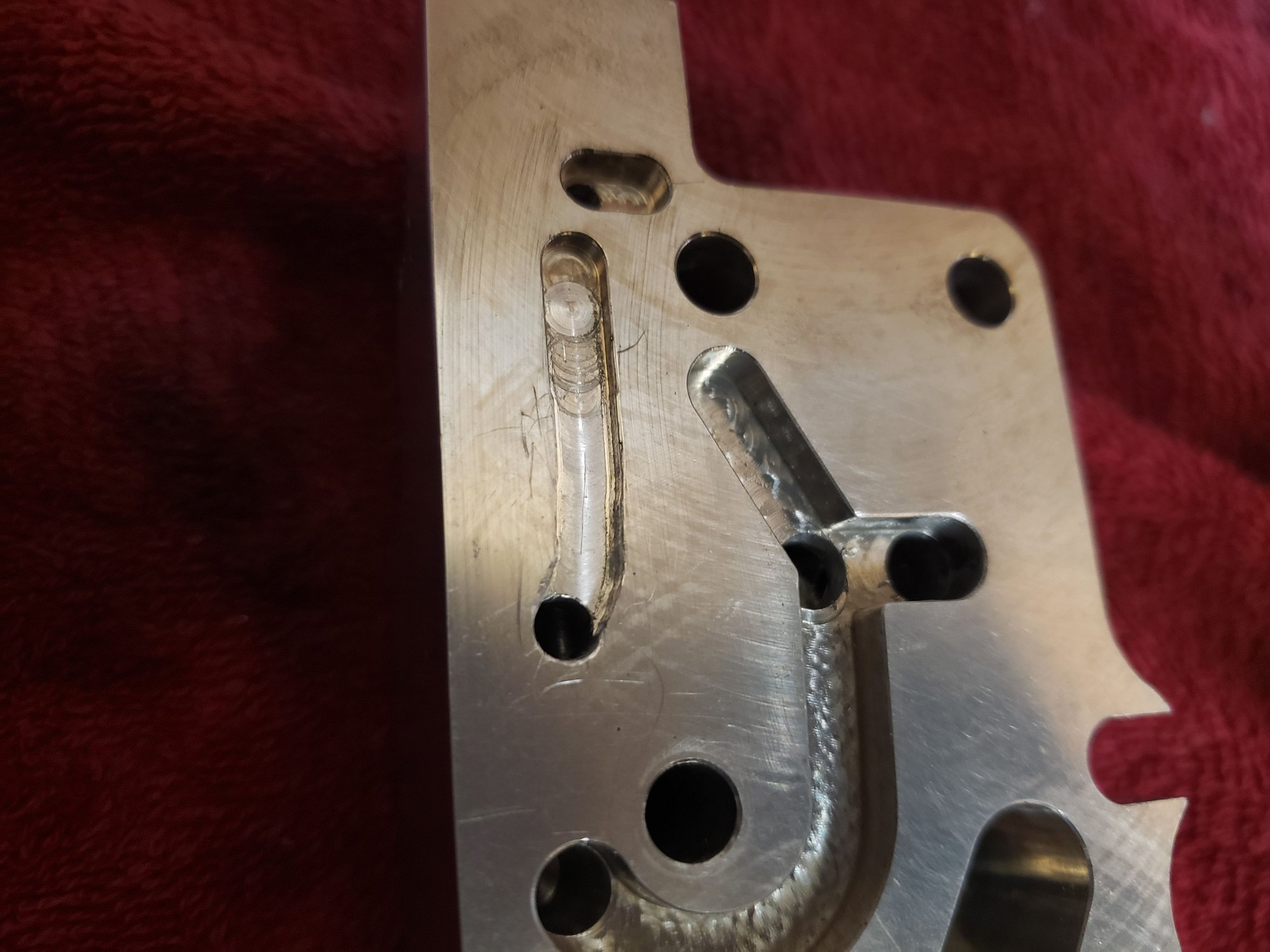

Milled that passage out yesterday in the oil pump. Had to go buy gaskets for it locally since the place I bought them from on eBay was really dragging their feet getting them in the mail.
Tomorrow I should get those overdrive gears so I can proceed putting the whole bottom end together.
