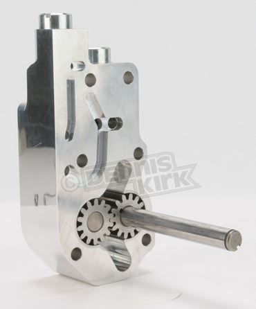

In conjunction with the shitty oil passage going into the pinion shaft. Basically the oil passage is the thickness of the gasket and about 1/8" wide. Here's an illustration of this location (it's the pic I emailed to Ron for confirmation):
If you compare that passage to the OEM pump you'll notice it's machined all the way down to that lower hole. According to S&S, the HVHP pump is designed to work with the SA cases (which also have piston oilers) so that narrow passage is plenty for oiling the pinion.
Old Jan 2, 2021 | 06:56 AM
  #496
Mattbastard's Avatar
Mattbastard
Joined: Nov 2009
Posts: 4,315
Likes: 1,663
From: Tampa
For reference, here's the normal S&S oil pump (the non HVHP one). See that passage?

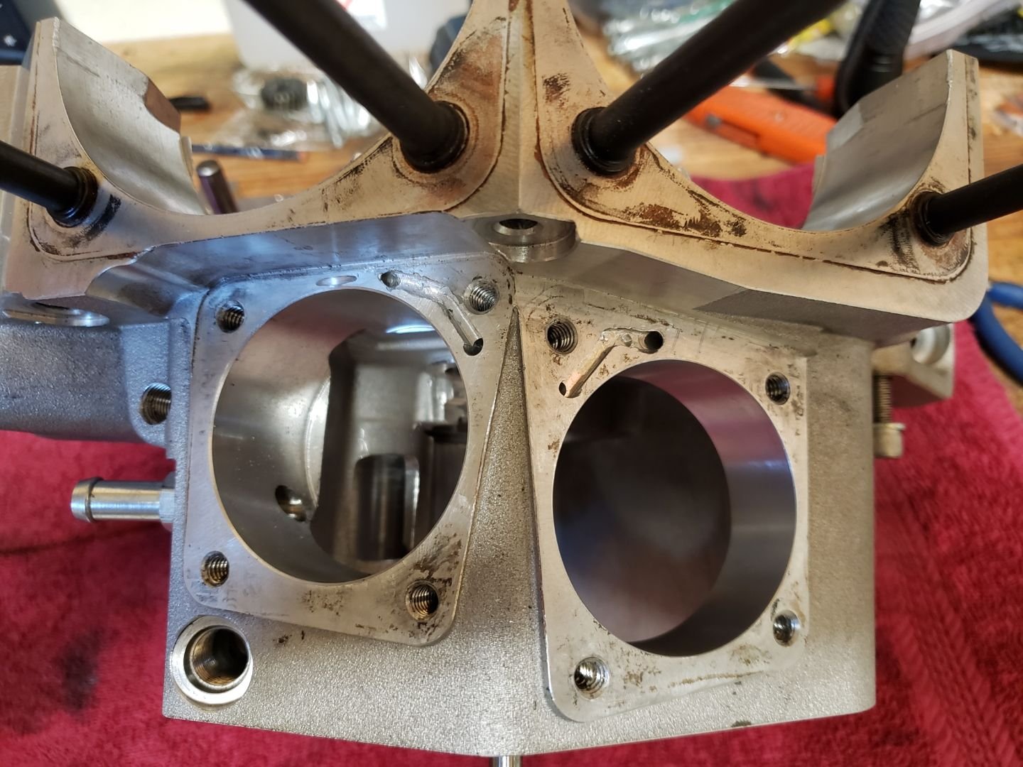

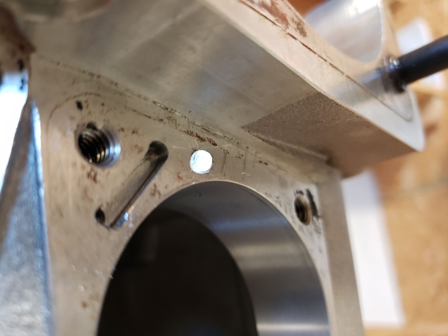

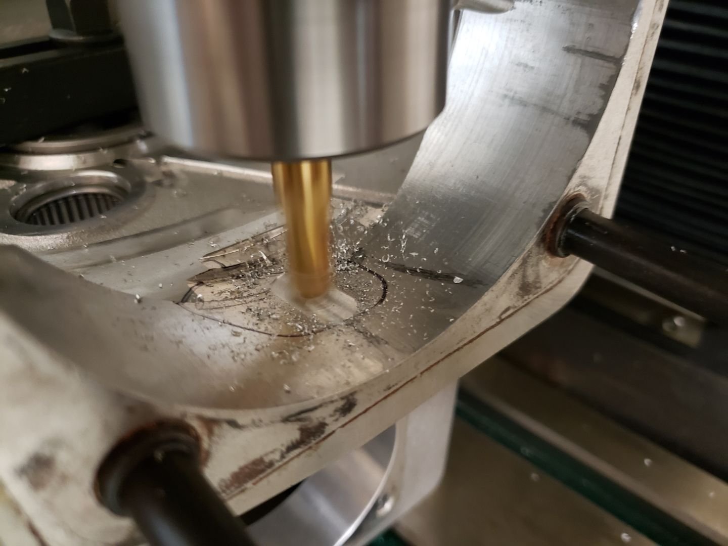

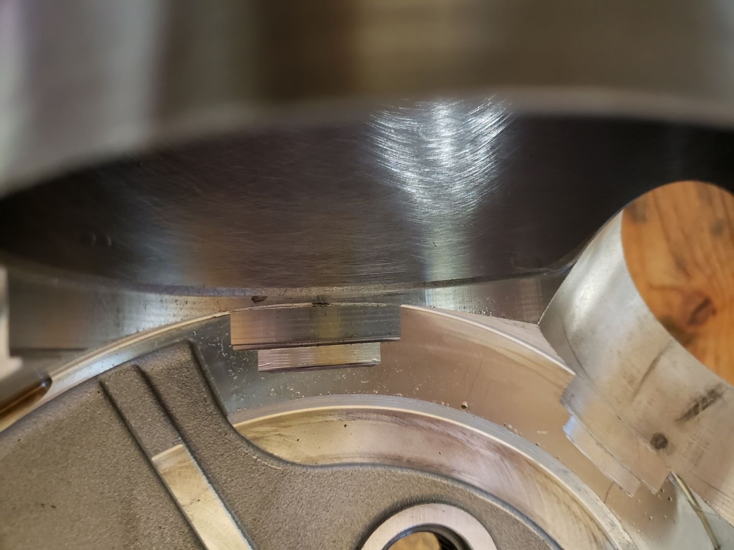

Started working on the piston oilers today
Cylinder as low as it goes (no base gasket)
Fired up the Grizzly mill:
Resting in place:
Fits loosely but not much breathing room

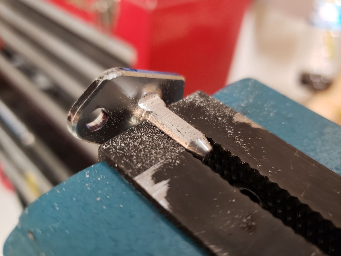

Starting the holes, drill and tap slowly..... Only get one chance:
Old Jan 4, 2021 | 06:03 PM
  #498
Mattbastard
Joined: Nov 2009
Posts: 4,315
Likes: 1,663
From: Tampa

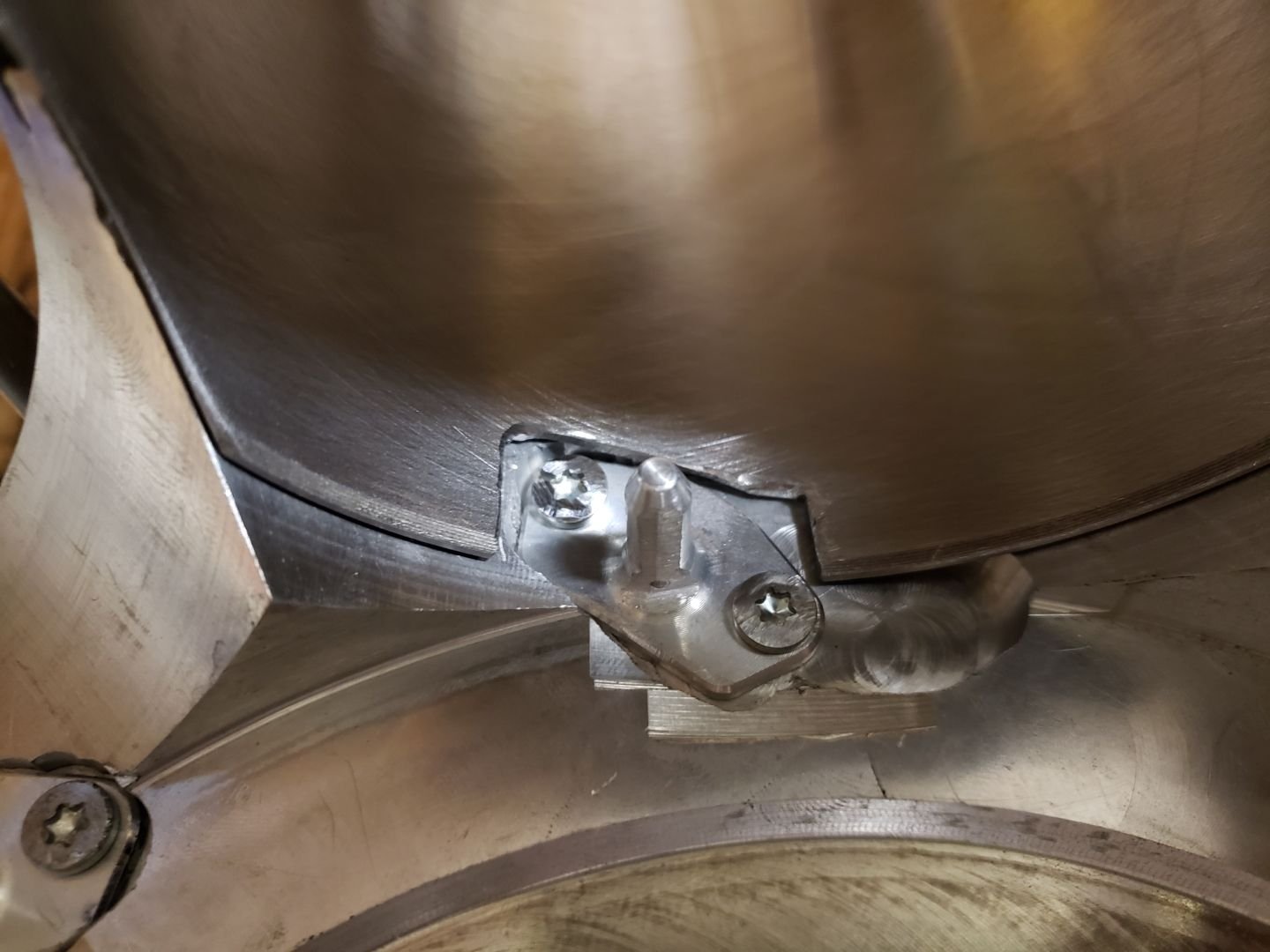

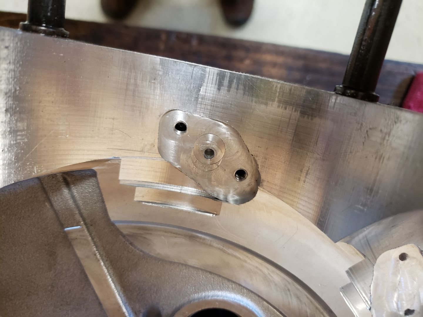

Starting the oil passage from the high pressure channel feeding the lifters. Say a few Hail Mary's first...
After some tedious moments, drilling, checking, changing sides, drilling some more, checking, etc... YAHTZEE!!!!!

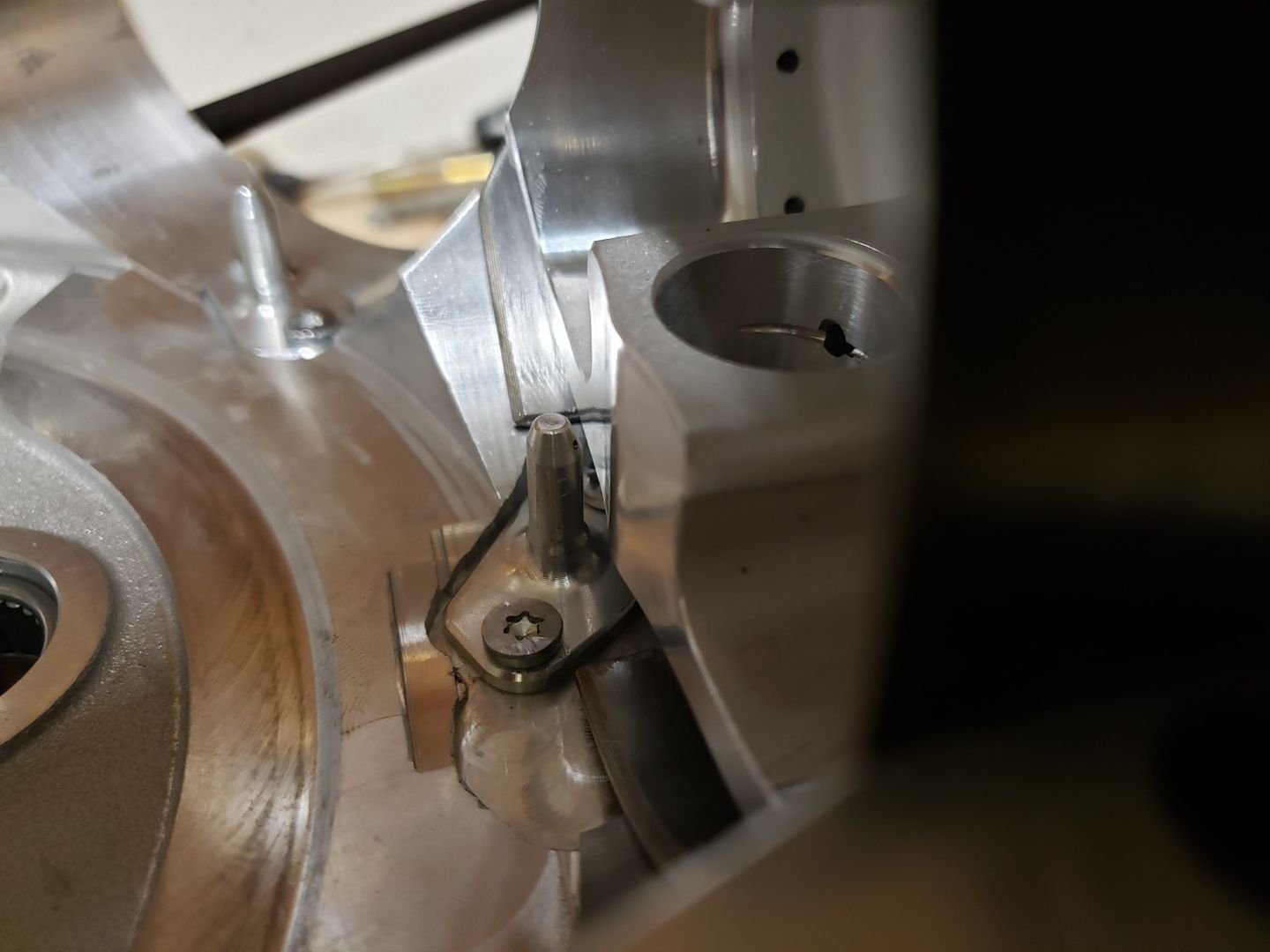

Making a little more room between the oiler and the crankshaft flywheel
Ehhhh Like A Glove......

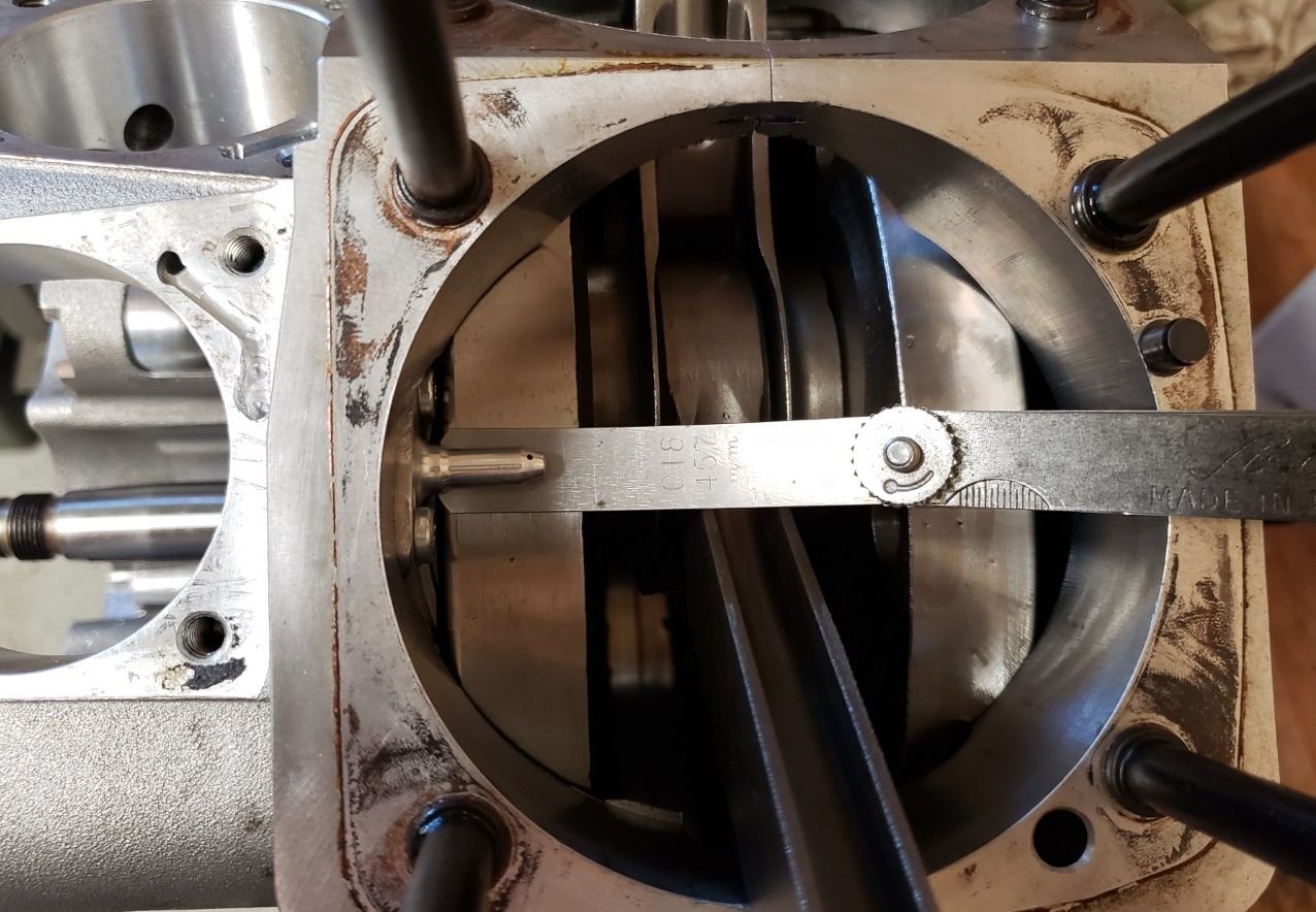

18 thou under it and a little more between the crank and the lower mounting screw. I had to mill the screw heads down a bit for clearance:
Old Jan 4, 2021 | 06:07 PM
  #499
Mattbastard
Joined: Nov 2009
Posts: 4,315
Likes: 1,663
From: Tampa

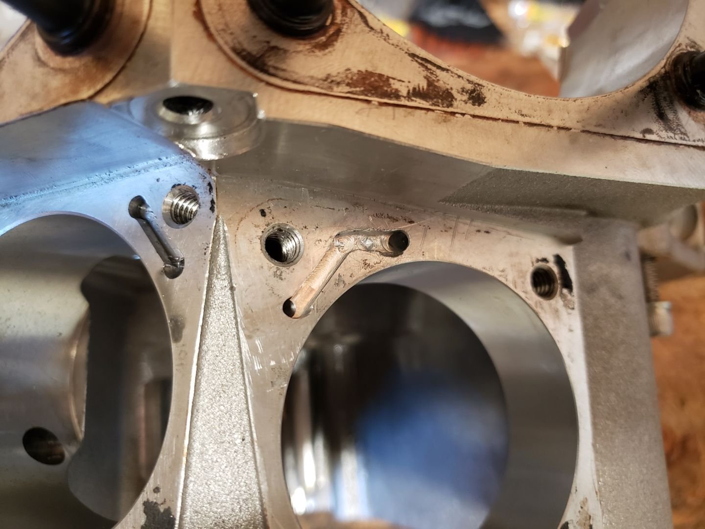

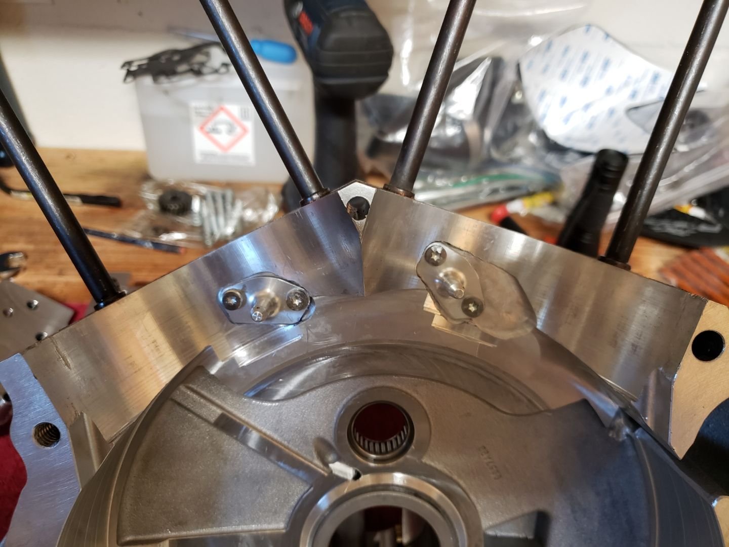

Hand milled the passage after drilling a few holes with my Dremel

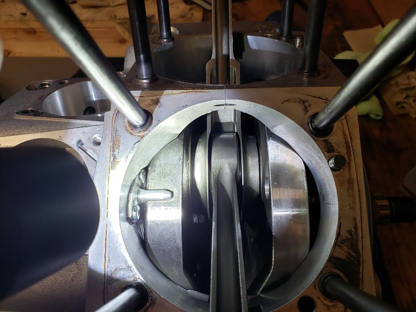

Rear cylinder was a bit harder than the first. I had to scoot the oiler forward more than intended due to complexity getting oil to it. Mill made quick work of it.
Both pointing towards the rear of each cylinder.
Notch out the cylinder skirts to make room
And the piston as low as it will go to check for clearance there too
Now to put the engine back together.

Wow.. nice Job. I hope it works well enough to control thermal expansion.. What will the piston to cylinder clearance be?
