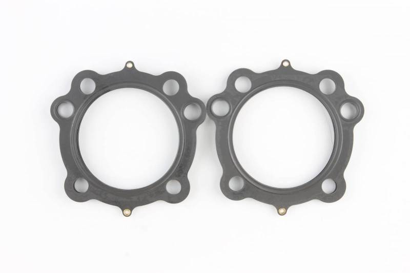

Remember to hold the throttle wide open when checking compression.
Take a look at the head gaskets, see if you can see the rivets that hold MLS type gaskets together, that could provide a clue if the heads been off.
