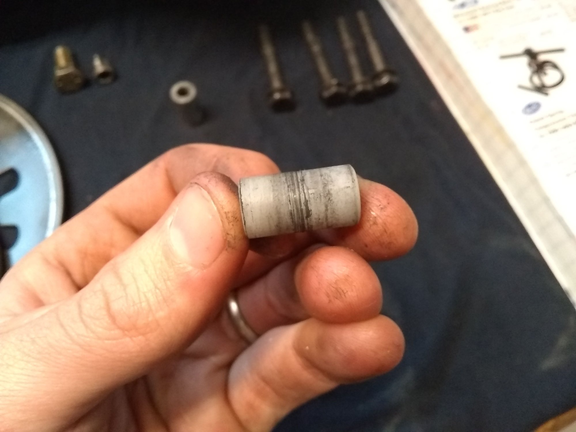

This is what I found with the Pivot pin. A little bit of wear, so I'll probably replace it just for good measure but wasn't enough to convince me this was my only problem
