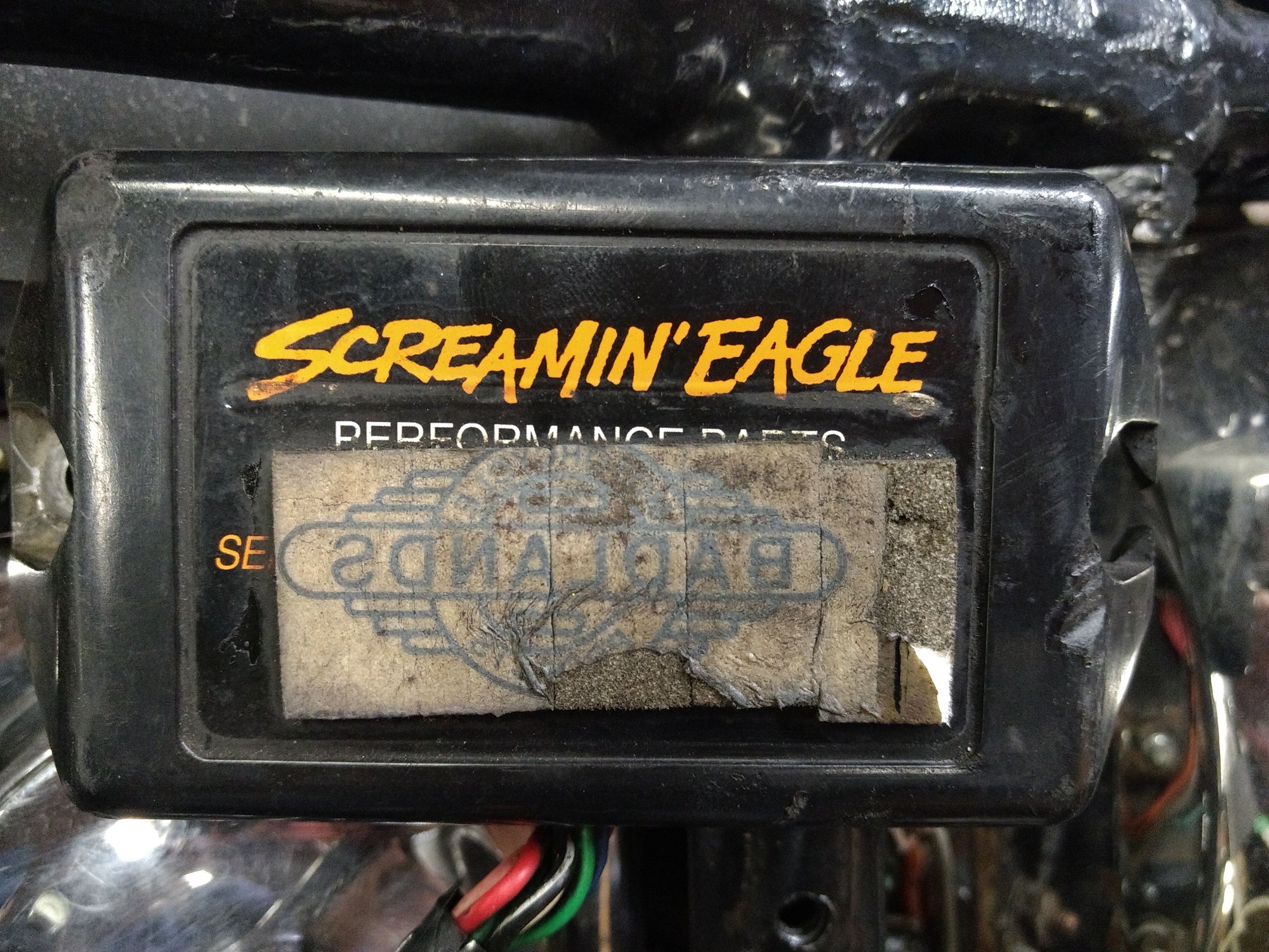

The one I have doesn't have the switches.
Thanks, I really appreciate the offer. I think I’ll eventually go for the dynatek 2000.
