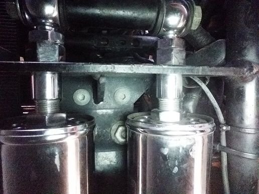

I looked at the Progressive 422's under my Heritage Classic and I noticed that on the back end of one of the shocks the black housing (yellow circles) seems to be protruding out farther than the other one. I'm assuming that is caused by an uneven adjustment of the shocks when I had them installed. I've never had any practical experience with this type of shocks so if that can be adjusted out would I make the adjustment with the preload in the red square or with the ride height in the blue square????

You would want the thread count in the red and blue squares to be equal on both shocks...
Yeah progressive told me the same thing.
They told me that it was ok if the barrels were unequal as long as the threads matched on the adjustments.
I wore out 3 bushings taking their advice.
Now I make sure the barrel lengths are exactly the same so that I know the pressure on each is equal.

I've worn out one bushing on the long barrel shock. I can't believe those dick-holes just changed the bushing and threw the shock back in the same way it was! The new bushing has been in quite a while. The first one only lasted two weeks.
Here are actual pictures from under the bike. Threads are the same but one barrel is obviously longer.
So what should I do from here? Adjust the preload until the barrels are equal

So what should I do from here? Adjust the preload until the barrels are equal?
I would.

I'll give it a shot. Thanks.

To do it right, I would take both shock out and line them up so the mount centers are identical to each other.

we use round shafts along a board and measure the lengths exact -
you may or not have noticed a waggle turning one way verses the other
