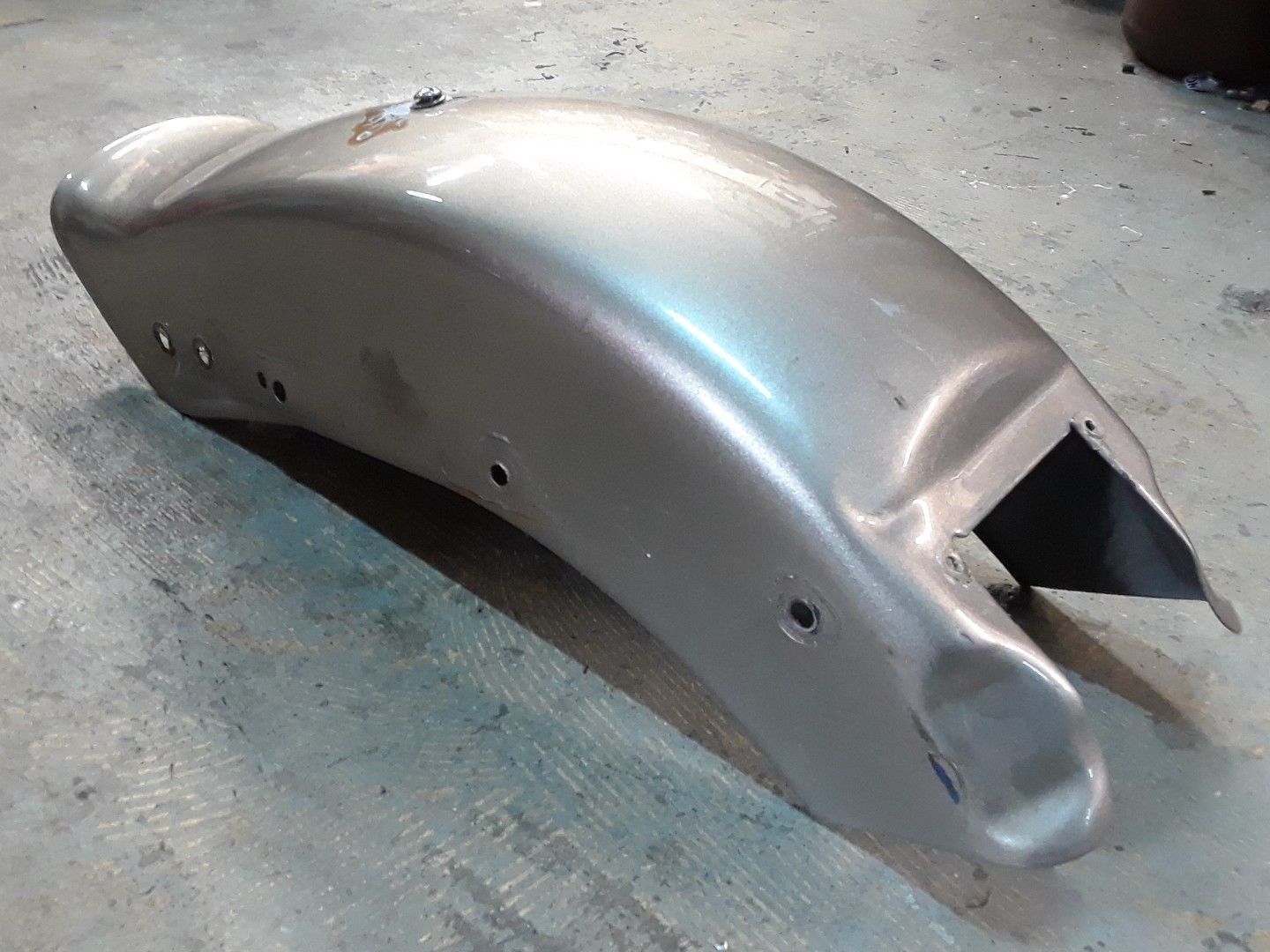

Look under the seat...a late 96 has a fuse box under there with a cutout in the fender...an early 96 does not.
The never style wiring should be more waterproof...never had problems with the older ones
The later ones had the nicer hand controls...and self canceling turn signals that actually work.

Awesome, Tom.
Your advice and pic are sparking some memories of the '96 I had (stolen in 2005).
