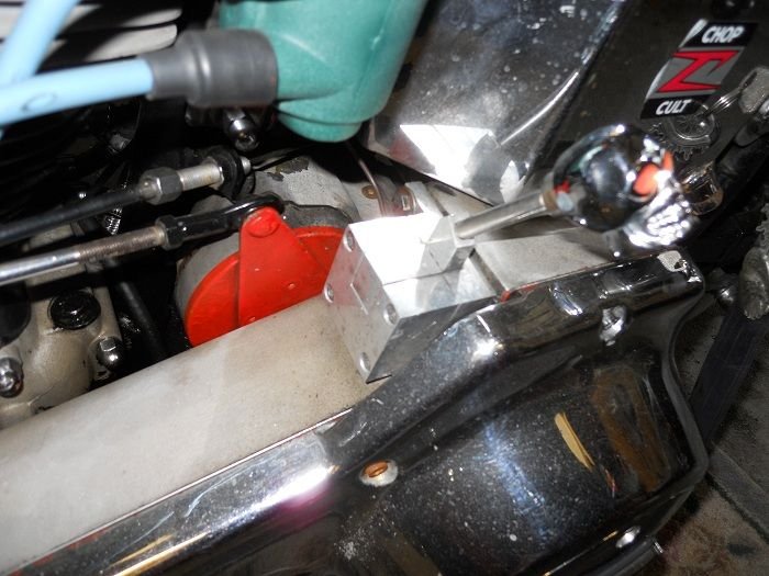

I've seen those lever devices, but never figured how they work. When you operate the lever are you physically engaging a solenoid? Or physically engaging the bendix while completing the circuit to the starter motor?

Looked at the piece on the J&P site. Now have less understanding of what it does than before, LOL!
From the wiring diagram and your picture, it appears there is a set of small contacts in the device that completes a circuit to a relay. The relay picks up and completes a circuit to larger relay, which completes the circuit to the starter motor. Additionally, the lever device appears to manually engage the bendix-starter clutch, rather than a stock-type solenoid engaging it. Once the bike starts you move the lever to its "off" position to disengage the bendix drive from the ring gear, and also opens the contacts to kill the circuits to the relays, and thus the power to the starter motor.
Am I close?
Yes. All that.
The lever takes the place of the solenoid and energizes the starter just as the solenoid does when you press the starter button. It's basically a combination solenoid and starter switch. Like it was explained to me - "don't try and figure out how it works. Just wire it the way the diagram says and it will." So I did and it did and all was right with the world .Most expensive starter switch I ever bought but worth every penny.
