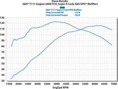

I do have a 106", but HP is more the concern than displacement and the recommended carb size. Case in point, new V111's* come with a Super E and they pull over 110hp.
*Yea, I know T111, but all things similar from S&S and Super E carb regardless
I also really like the following the S&S carbs have. I've watched two videos direct from S&S about installing the carb with initial tuning, and another on fine tuning based on AFR on a dyno for cruise and WFO. Good luck finding anything like that on the Mik or CV carbs! Yes, I understand the Thunderjet adds fuel at high RPM's. Personally I'd rather jet in the 13's at cruise to keep temps down and deal with a sub-40 MPG's while having an honest 12:1 AFR at WFO without overcomplicating the carb plumbing. I may change my mind in the future, but that's why they sell Thunderjets by themselves.
