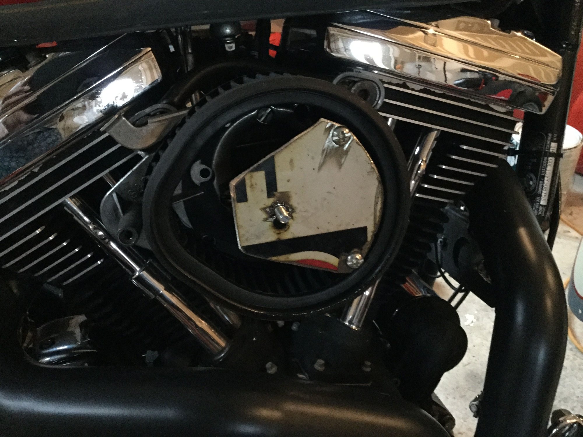

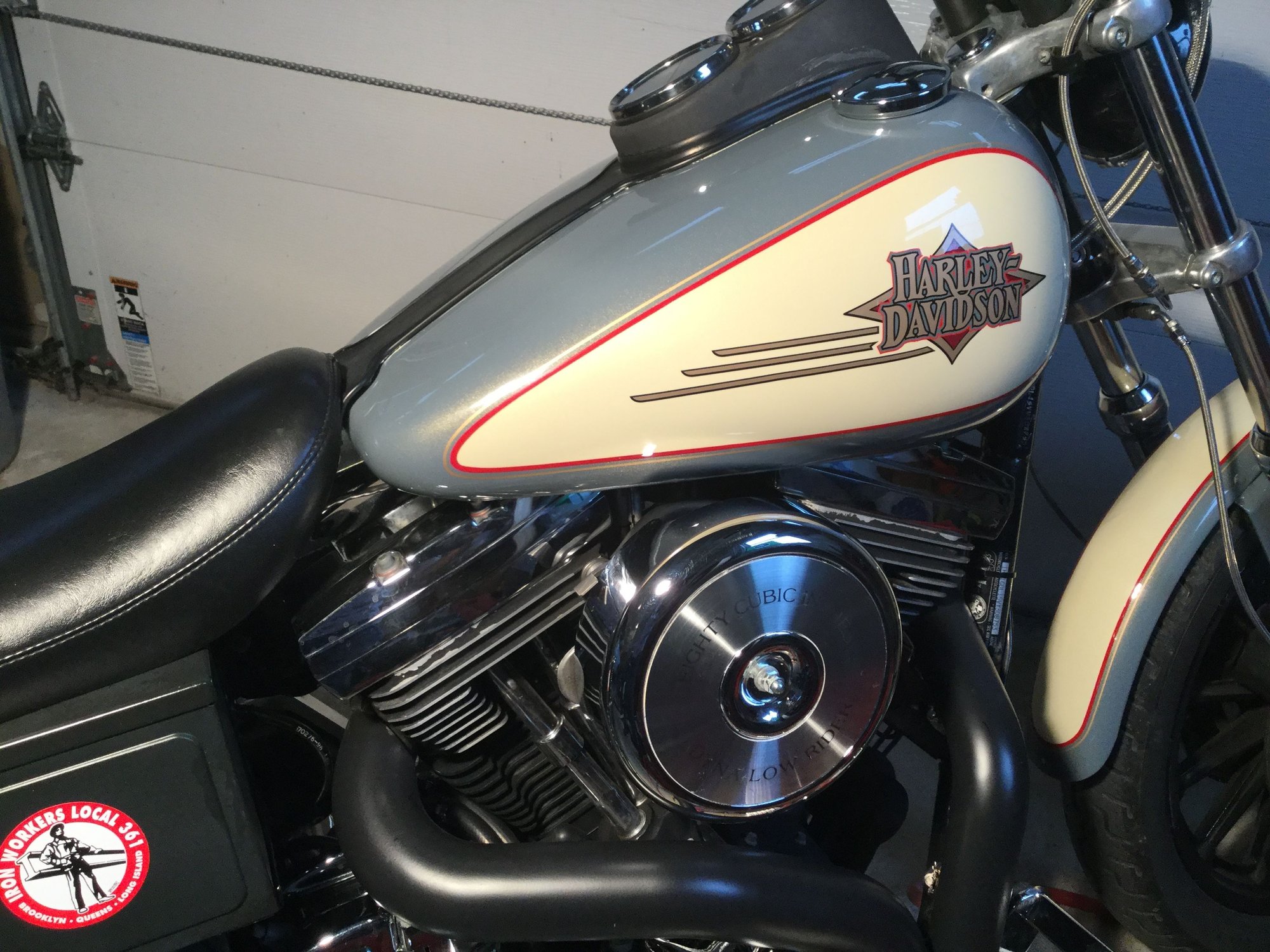

Originally Posted by Tony_N
Can you use a big sucker and stock air cleaner cover with the S&S Super E or do you have to use the tear drop?
I have the stock air cleaner on my Super E, I just had to fab a bracket, l’ll send you a pic if you’re interested
Sweet ride Luna! I appreciate the info. PM sent.
Hell post a pic of the bracket.
It's always interesting to see how someone solved a problem by making their own parts!!!!!

user 47363638's Avatar
user 47363638
Joined: Dec 2017
Posts: 4,506
Likes: 2,361
I used an old aluminum sign, cut it to shape, marked the two front holes that receive teardrop cover, make sure to have the filter on when laying out holes, then put stock air cleaner where I wanted it to sit and marked center hole and drilled(remove bracket before drilling) I then stuck a bolt through bracket with a couple of lock washers to keep the bolt from falling out while mounting or removing cover. I hope this helps.
