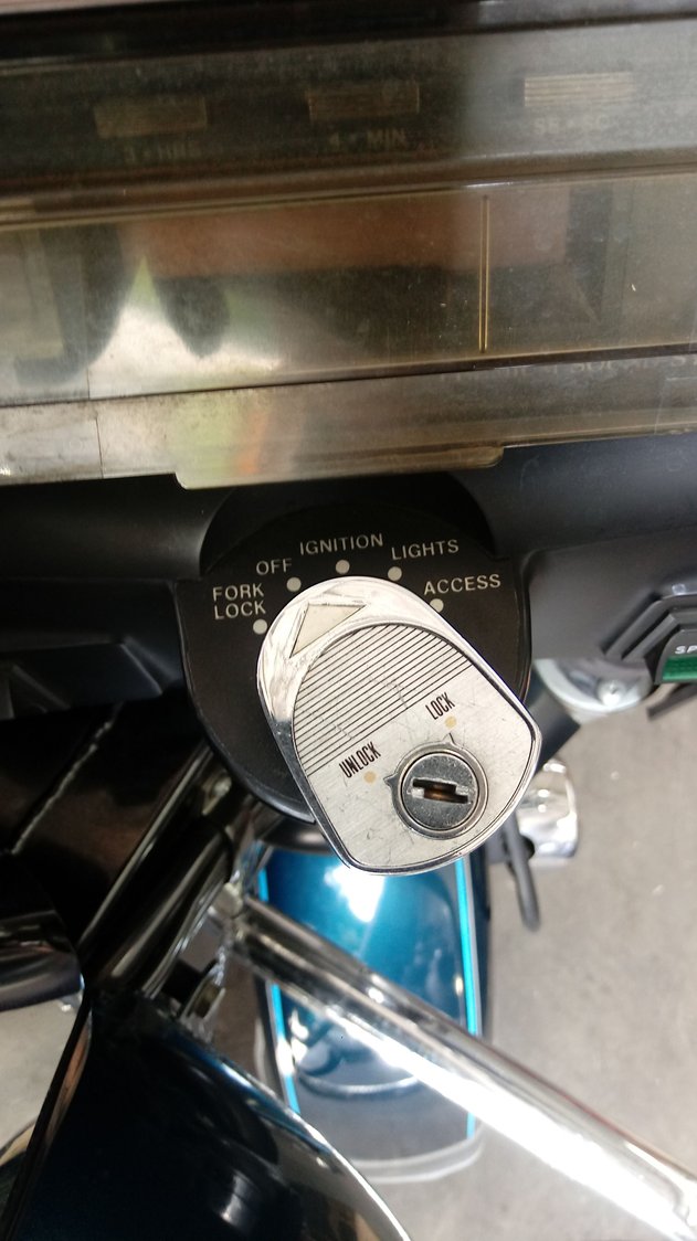

this is the switch on my bike, it has a seperate detent for lights .There are no lights on until the switch is pointed to "lights"
I load tested the battery yesterday. It's definitely a good battery. So that rules out the battery, or should, anyway .I haven't had time to do any other diagnosing today

On that bike, the headlight jumper is between the breakers inside the fairing.
Sounds like The Dreaded Click syndrome to me, if he did pass all the tests exactly as I wrote them out. In particular, voltage at the battery terminals with bike running at about 2K RPM test.

I don't hear anything. No soft click, no loud click. Nothing. But, it will start using the switch on the starter. But with the lights off, the handlebar start switch works fine. As far as I can tell, the wiring hasn't been messed with. There is a relay and a circuit breaker above the battery, and those connections are clean, and tight, as are the battery connections. I haven't really been able to check out a lot, as i just got the bike. But I do know the battery is good, abd has a good charge, and more than its rated 340cca.

I get what you're saying now. Sorry for being dense before. It didn't occur to me that someone might have pulled the jumper.
It will be interesting to see how this gets resolved. The presence of that pulled jumper and add-on starter switch says someone's been working his way around this before.
I don`t think the problem is whether the lights are on or off, I think it has something to do with the ignition switch or it`s wiring.
When it is in "Ignition" position the bike will start, but when in "Lights" position it will not...
Put the switch in the Ignition position, then read voltage at the ignition breaker.
Do the same with the switch in the Lights position.
Tell us what your voltage readings are.
I suspect the switch is not sending power to the Ignition breaker when the switch is in the "Ignition" position.
