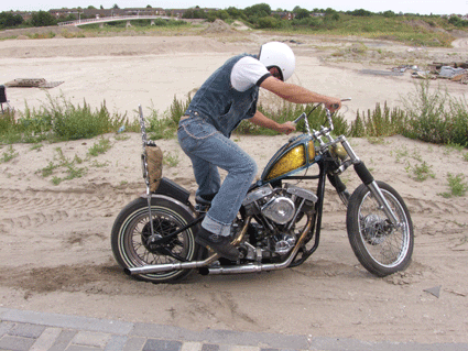

I played with a 5 speed kicker many years ago. I learned to hate it. I didn't run it long.
The ignition I used was a Crane in the cone. What a FKN POS. Crane knew they shut down when hot which I didn't find cute since I live in Arizona. You'll need a good ignition that has a kick option.
The York kick kit is junk. The Billet Bilt is built like a tank. I have no experience with anything else.

Originally Posted by Tom84FXST
This is the one on the bike in the picture.
https://store.58cycle.com/Custom_Chr...kaAun0EALw_wcB
Just curious where did you get the frame ? All the ones here are 200 series rear I want one with a normal 130 rear on it.
Paughco. Incidentally I have that frame for sale right now in the misc. parts section. It comes titled already if you buy mine.

Not to sound ignorant but what happens to the clutch cable and throw out bearing if you use the custom chrome kit?
Valid point where does the clutch cable get relocated to ?
Nothing changes
