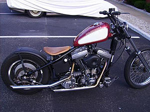

I had a kickstart kit mated to a five speed for years. The bike was kick only and it held up pretty well. My exhaust pipe options were limited.Need Help? Kick start and Evolution-photo229.jpgNeed Help? Kick start and Evolution-photo473.jpg

Originally Posted by misfitJason
I had a kickstart kit mated to a five speed for years. The bike was kick only and it held up pretty well. My exhaust pipe options were limited.Attachment 595704Attachment 595703
did you use baker or someone else ?
This is the one on the bike in the picture.
https://store.58cycle.com/Custom_Chr...kaAun0EALw_wcB
