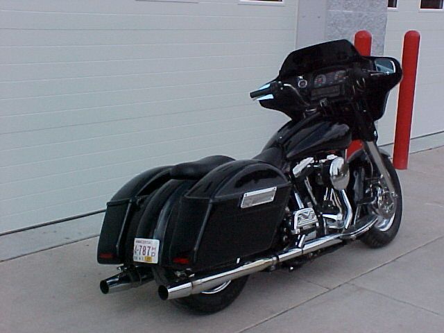

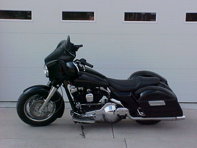

You could flip the swing arm. Mines been that way for 14 years with no ill affects to the swing arm. You'll have to work on the shock adjustment if you're running air shocks. I put some late model on with the higher pressure and it works ok for us. It's stiffer than noon flipped, we're a little over 300 lbs 2 up. Check your wires and bolts under the fender if you do it.
The photos give you an idea of the ride height. Speed bumps need attention but other than that I don't normally scrape unless I really lay into a curve.

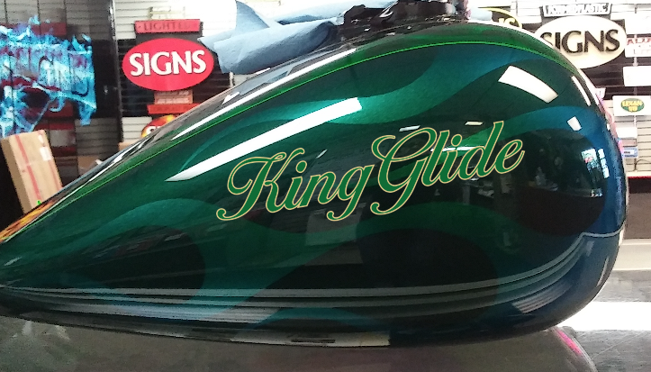

The paint job on your tank is so good we can't see it properly because of all the reflections! Is it a 6 gallon tank, as part of your later set of tins?
Old Nov 2, 2018 | 08:17 AM
Kingglide549's Avatar
Kingglide549
Joined: May 2018
Posts: 4,576
Likes: 978
From: Viet Vet, crossroads
It is whatever comes on a 2015 SG
I think it is slightly bigger.
It is a stock HD collor afaik.
The whole set cost me less than a paint job done by me ,under a grand.

It'll be a 6 gallon one, similar to the 2009 one I have on my Evo Glide. You may find it is a challenge to install, simply because it doesn't have the same cutaways in the underside. A US gallon is almost exactly a 6" cube, which they have managed to squeeze in, hence the new tank is a little longer, has less cut-outs underneath, also the top surface is bowed upwards a little. All very subtle stuff, giving us a familiar look, but by no means identical to the old 5 gallon tank. You will need a suitable console as well. Let us know what you find and I may be able to offer some tips.
