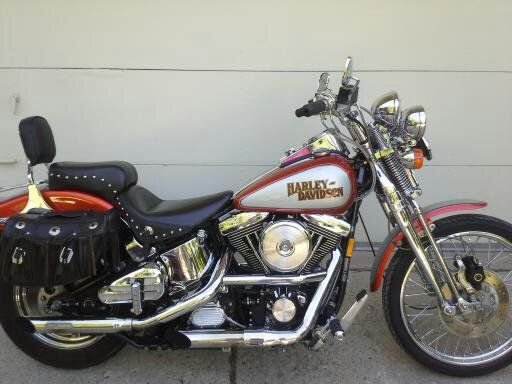

Thank you for all the replies. In speaking with the current owner, he described the last owner as a true biker (insert your own definition) and that his dad was a Harley mechanic. He also said the fenders were not stock, as well as the bars and exhaust. He did say he has all of the original tins, handlebar and exhaust.
The owner is in Florida for 10 days. He said he will contact me when he gets back. I'll go look at it, but with low expectations and a suspicious eye.
I'll keep you posted.
Old Jan 15, 2019 | 08:47 PM
ecsjr's Avatar
ecsjr
Joined: Feb 2008
Posts: 58
Likes: 18
From: Chicago Suburb, Illinois

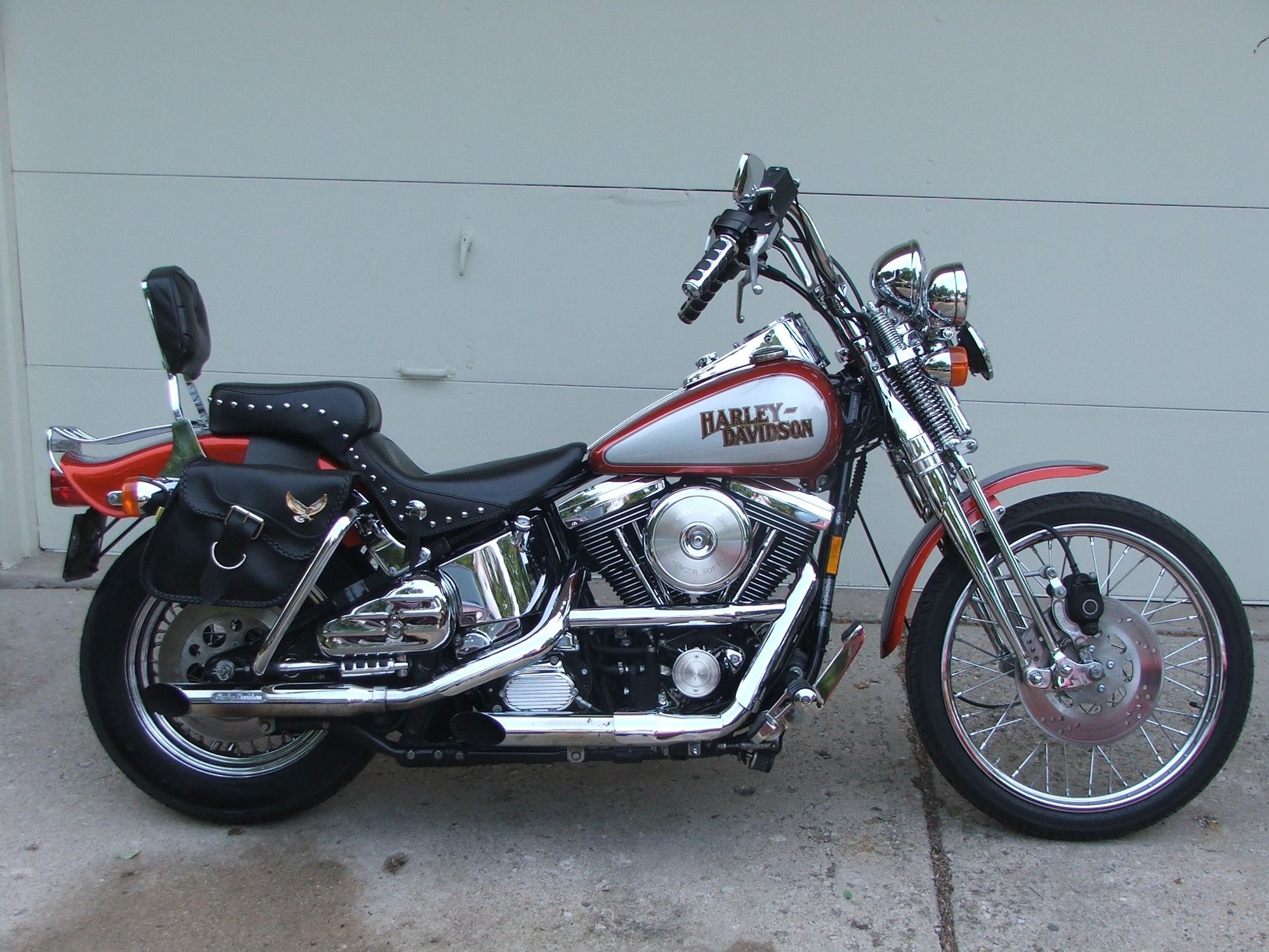

I had a 1990 Springer....(see pictures) Not sure what that bike for sale is.
The fact that he didn't talk about the changes made and calls it "mint" would scare me away.
I liked mine a lot...sold it to buy an '07 CVO Springer. I grew to embrace the dirt-bike front fender.
Ed
Original
Repainted
with lower bars....big improvement to me.
