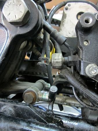

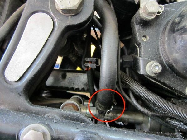

Old Jan 17, 2019 | 07:31 PM
panz4ever's Avatar
panz4ever
Joined: Oct 2005
Posts: 7,503
Likes: 3,729
From an almost stock 1988 FLSTC
frame plug for oil line

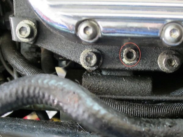

...and for good measure, the transmission drain plug

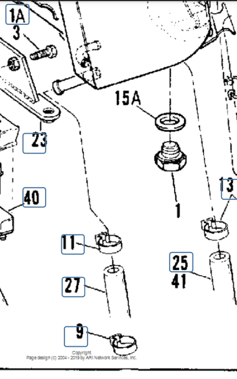

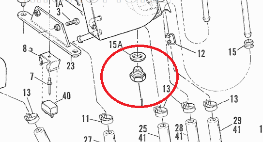

Originally Posted by grbrown
Take a look at Ronnies H-D microfiche website where you can see a diagram showing which hose is the drain.
Ronnie's shows no hose on an 86...just a drain plug on the tank...that is the way my 84 is...
I use an oil radiator hose to direct the oil to the pan...
Old Jan 18, 2019 | 07:22 AM
barneyboy's Avatar
barneyboy
Joined: Dec 2017
Posts: 5,077
Likes: 3,293
From: Plover, WI
That diagram covers several model years. Part #27 is the drain hose used on the 86.
