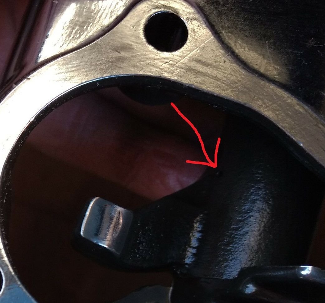

I guess first thing is to check that the oil was getting all the way to the valve stem.
Looking at this picture, was wondering if this oil hole by the valve is angled towards the stem.
You know I'm going to have to take a closer look. I currently have everything over to a friends shop in New Jersey so i'm not going to be able to get to it right away but I will take a look at that. You got a good point. Thanks..
