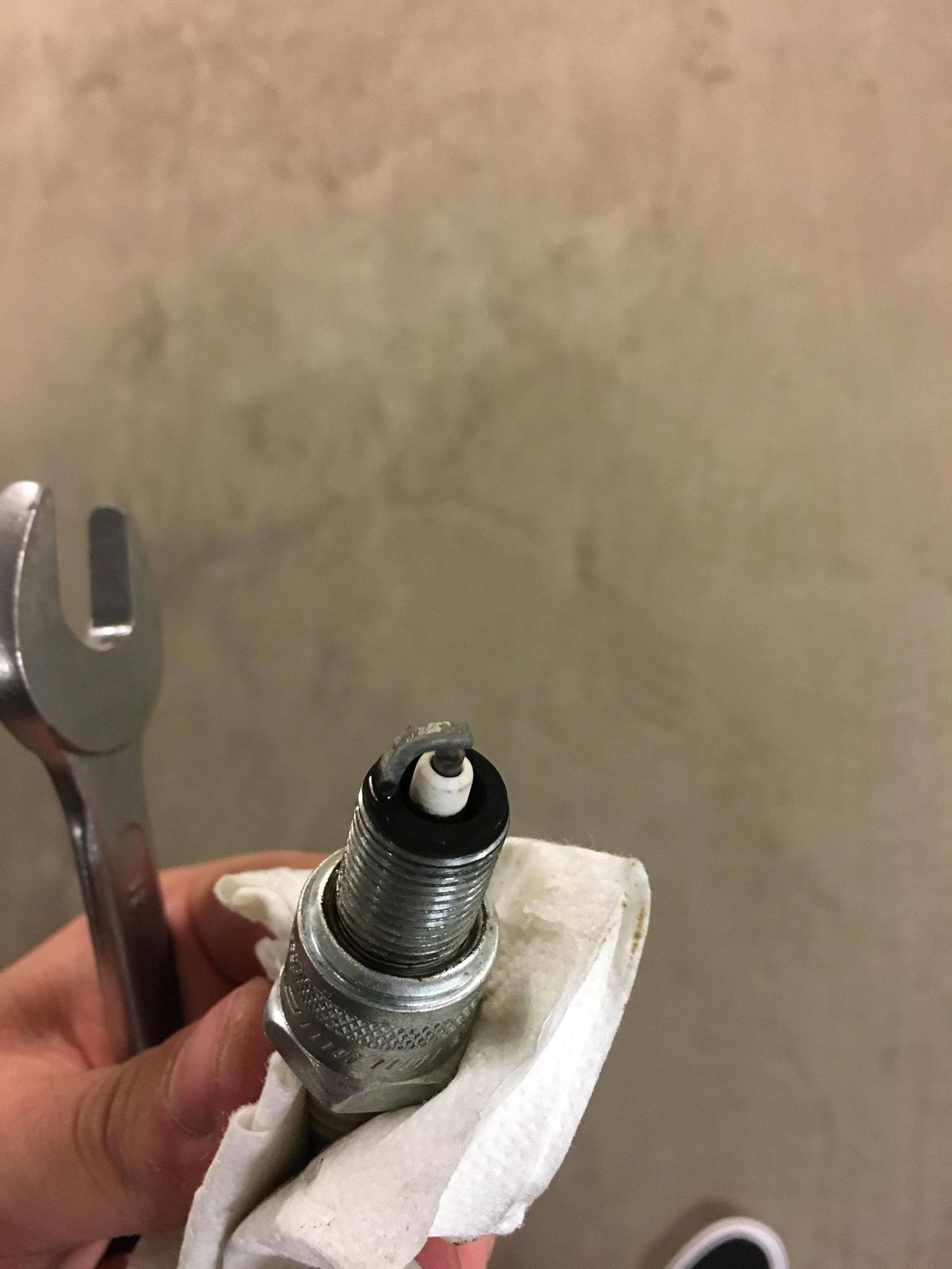

So now spring is in the air, and I finally took my bike out for a ride today. 43 degrees, but still enjoyable. Bike coughed some during start-up, but went away with the enrichener on. After it was warm and enrichener was turned off, bike ran good . Still had some coughs now and then. Tried adjusting the idle mixture screw, but it did not seem to cause any reaction. No change in RPM and idles just fine. Took out the spark plugs and they seem a little bit lean maybe?

Thank you guys. Think I have stock needle (see pic), but will order a 88 sportster needle and new emulsion tube. Never checked the float setting, so I might dig in that also. I also remembered that I never checked the intake flanges to see if they're warped, so I will order new flanges as well, just to be safe. But I am wondering though, will I do damage to the motor if I ride it as is? Supposed to be warm and sunny the next two days, and I won't get the new parts before next week.

That plug looks like low speed rich, what RPM are you idling bike at?

Today's fuels will not leave a deposit on the porcelain like older fields did. You see the black ring on the plug surrounding the porcelain? It's black cause your getting to much fuel... Your not lean.. And as thc said put the S&S back on..

Ok. I do see your point, but that white deposit on the tip though, is that not from the plug getting too hot? A too rich mixture could explain why the idle mixture adjustments does not affect the RPM I guess, but would not explain the coughing?

I don't see the white tip your talking about... Is your motor stock? If so replace the 48 with a 45 and keep the 180 and go from there. Also Remember that putting a needle from a sporster in that has a different taper will also add more fuel sooner as well as raising the needle with more washers. The S&S does not have as many variables and is all I use... As for the sneezing make sure you don't have any vacuum leaks. Brake clean sprayed around the intake seals and sprayed from the carb side will determine if you have any leaks... Usually you can best pinpoint the spray with the red straw that hooks to the nozzle.
