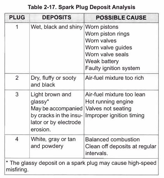

Originally Posted by BrandonSmith
Modern fuels combined with the super hot plugs Harley puts in their engines make plug reading all but impossible. Accurate AFR is acquired by the use of a wideband O2 sensor in the exhaust.
Old Mar 28, 2019 | 04:50 PM
98hotrodfatboy's Avatar
98hotrodfatboy
Posts: 21,093
Likes: 7,622
From: Poolville
Yup.....
