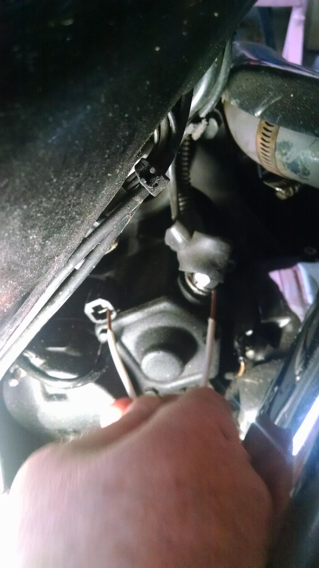

Left side behind the fairing. In a pinch you can start it with a piece of wire by jumping these connections.

You may be able to remove the headlight assembly to gain access to the starter relay. IMO easier than removing the outer fairing. Looking thru the headlight opening in the fairing, the brake relay (left) and the starter relay (right) should be just to the right of the fuse & circuit breaker blocks, and straight down from the speedometer. The speedometer cable should pass right by the relays.
