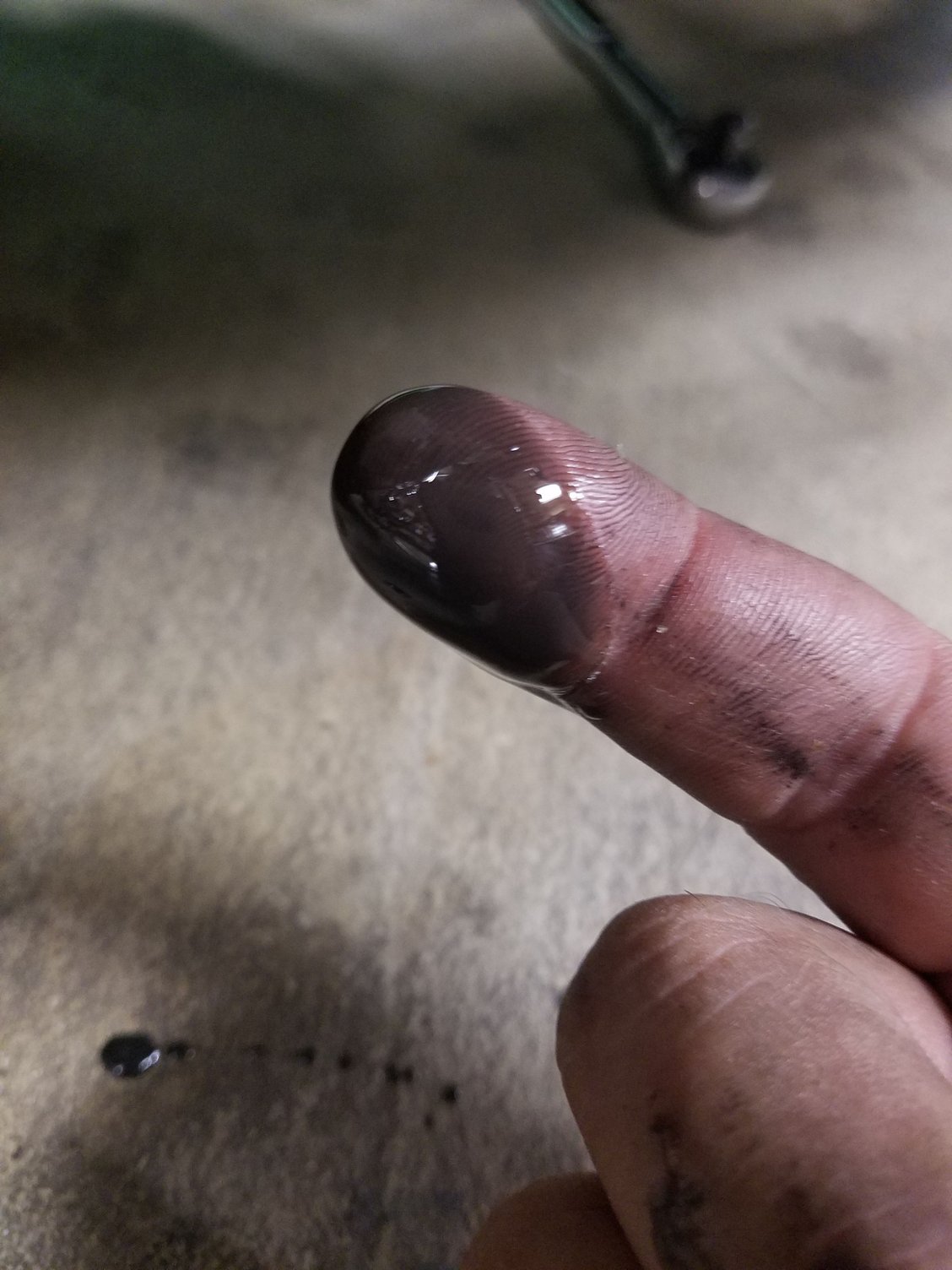

well it doesn't look that bad. I did notice that clutch adjusting nut did seem a little stuck on the plate that ( the one that's snap ringed into the inside of the clutch basket. maybe I didn't seat it well?
I also feel like its pretty dirty for having less than 100 miles on primary oil. the push rod doesn't look bad to me either.
any ideas?
