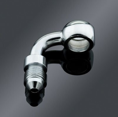

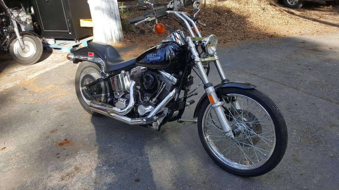

So, I'm putting new handle bars on my 89 softail FXSTC and I want to replace the front brake hose.
I'm looking in the JP Cycles catalog and they list 2 sizes of "Banjos" 3/8" and 7/16" both have the same size threaded end, (AN3)
On my bike, the banjo at the master cylinder appear to be larger than the one at the caliper.
Would I be correct in one 3/8 and one 7/16?

Screw the bolt out, and measure what size it is with an open end wrench....

The larger hole is 7/16ths and the smaller one is 3/8ths.
