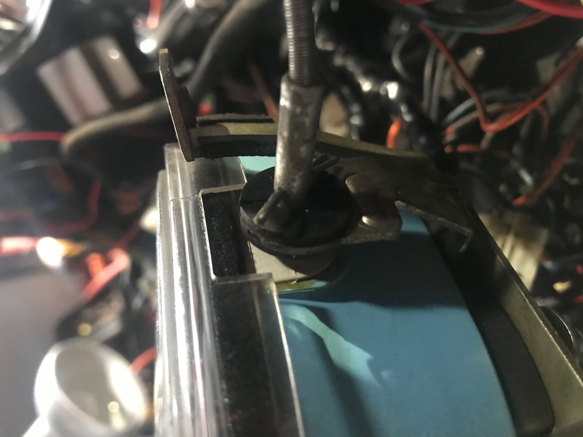

Hello,
Im currently fixing up a 1986 Electra glide Can anyone help me figure out how to remove the odometer rest cable.
i tried removing the ring on the inner fairing side but it just keeps spinning.
There a pin on the cable going into the cluster? any ideas?

Looks like you would remove the cotter pin and pull

^^^ Yup...pull the pin and it should slip right off.

Someone has Aggie-rigged the crap out of that. It is supposed to have a screw on ferrul on the end that screws over the male part on the speedo.

Yep. Pulled the pin and it came out
