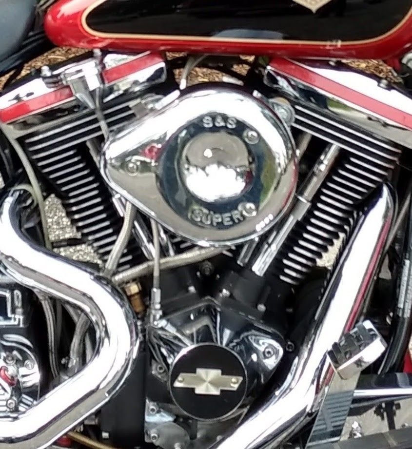

I've used 2, 24" x 3/8" stainless braided plumbing connectors for a sink and cut them to length to breath out the bottom just under the frame.. I'll dig up a pic and post later... They work great and look good.... Yeehaw...
And yes plug the port on the back of the airhorn..
this is the best pic I have..
Thanks, this is pretty much what I had in mind, what did you use to plug the carb.

A regular automotive vacuum cap. Believe it's a 3/8" and use a small zip tie to secure it. AutoZone...... Or Advanced Auto.....
