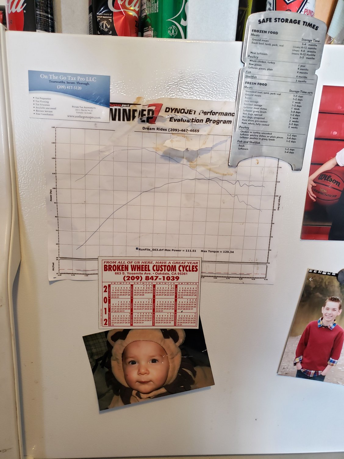

I doubt it.. A compression test will usually indicate the possibility of a cam being off a tooth by a 30 psi difference in ccp. Don't think you would hit those numbers if it was.. I ran the 9B for a while and did not like the low end... 3k and under..
Post up a dyno run sheet....

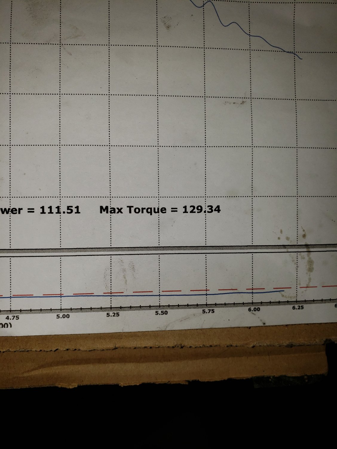

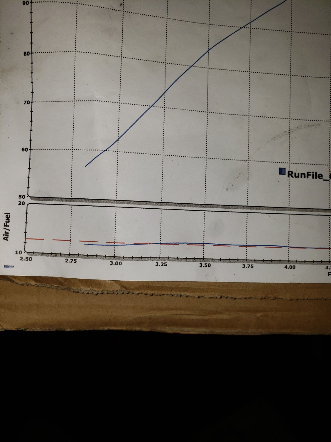

low rpm AFR and High rpm
That's not much different than my stock 111.

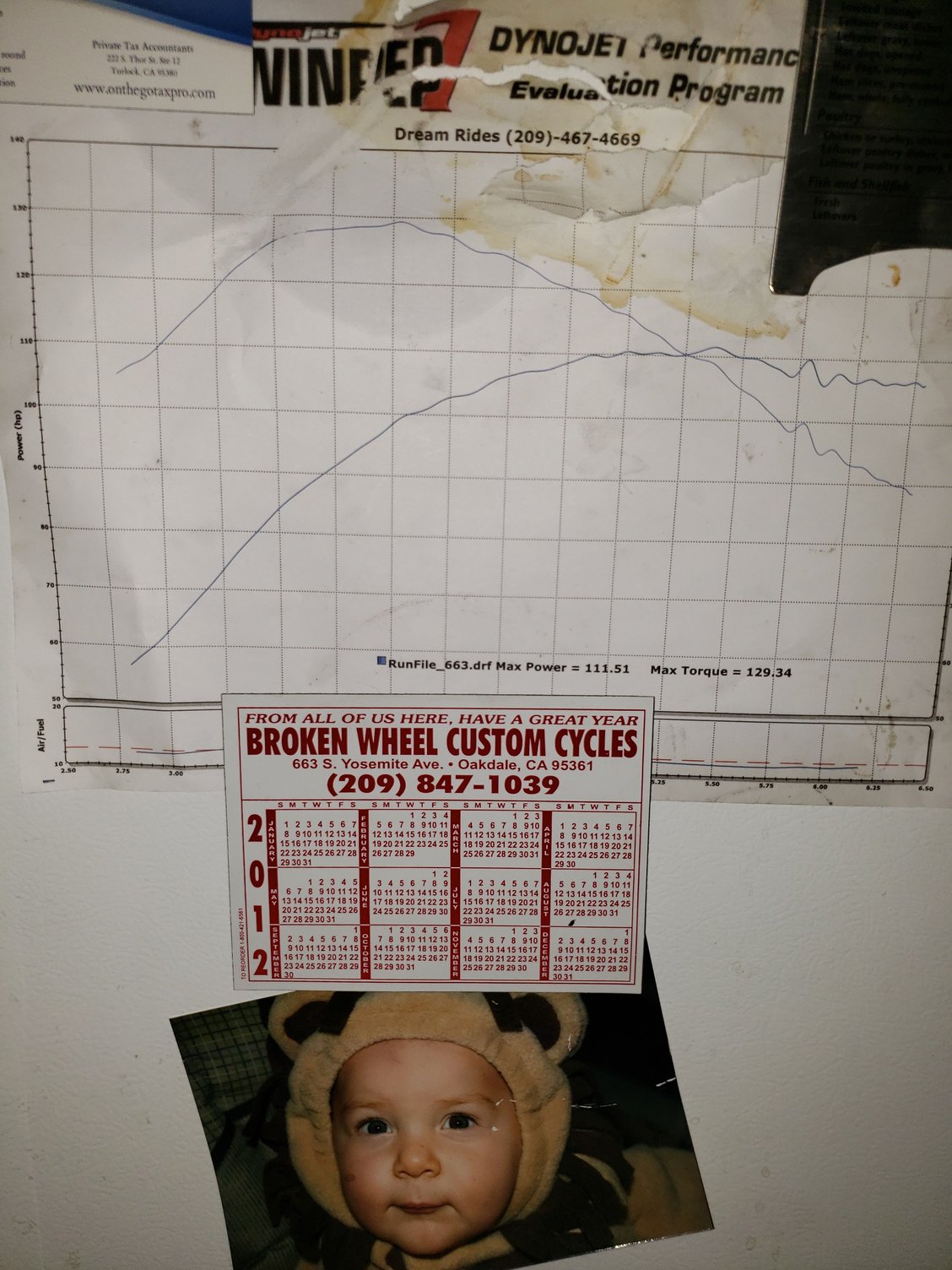

From: Poolville
Can you post up better pics? I'm more interested in the torque curve not the final numbers..

From: Oakdale Ca.
On my garage beer fridge
Yep I know something is off.

S&S 640 in there now

I would of thought the S&S 631 would be a better cam... Also with the 9b it's performing the way it was designed. Who did your heads?
Hannon's machine shop bay area Cali

631 doesnt come on until 4500-7000k beats the **** out of your top end. We will see how this 640 does with 11:1
