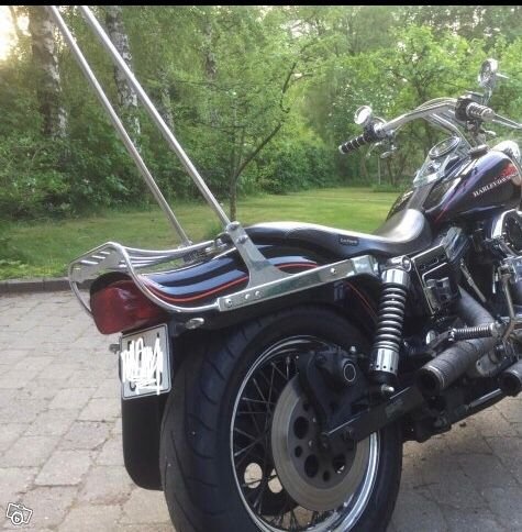

I have read several threads here on what’s the widest rear tyre possible on a EVO Dyna.
(Mine is a ’98 FXDWG).
Most answers say that 140 is the widest, but I also noted that a few writes that a 150 tyre in the rear i a possibility.
Anyone with a 150 tyre care to share if they had to make any adjustments to make it work?
Picture shows what I think is a 150 tyre on a ’94 FXDWG

You will have to go to a narrow drive belt and rear pulley. S&S makes a nice 1 1/8" belt that will take a good amount of power... Unless you go up to a 2000 up rear rim you will have to get an after market pulley.. 150 tire is Max unless you get a 180 or 200 mm tire kit for like $3000.00. not worth it. IMO..

The rear end of your bike is much the same across all Evos of that era. I've been down the route of trying wider tyres and with the stock 1 1/2" belt you have few practical options. In my case installing a 140 required trimming the rubber curtain inboard of the belt guard, to fit a 150 I had to go to a narrower belt, as hotrod suggests above. Fortunately all three tyre widths, 130, 140 and 150, will fit your stock wheel. I have subsequently gone to a 160, but that is another story!

Ok, thanks for the info!
I guess I stay with the OEM size then,
to much work involved for a few mm extras
