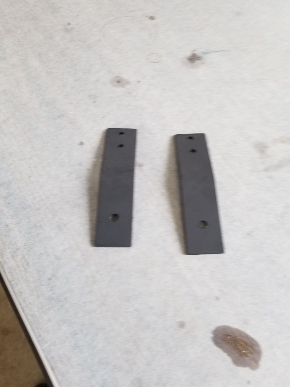

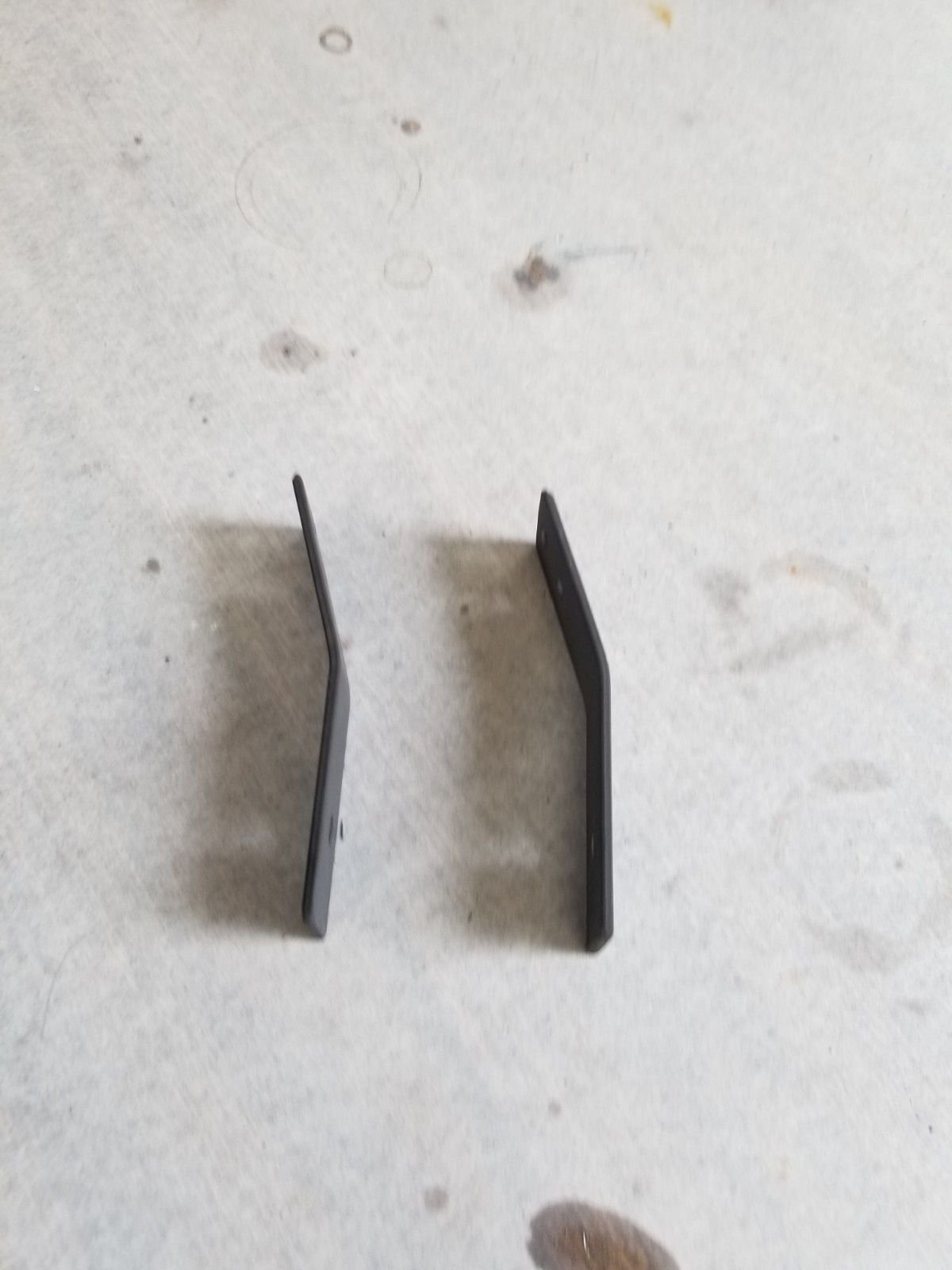

I tried one of those too and it didn't fit either.
I ended up making a couple brackets to move the reservoir.
Here is how it ended up
