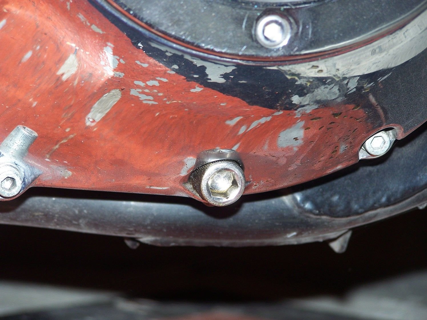

Had the same problem on my 1996 Electra Glide … I pulled the primary, drilled and tapped the hole for 7/16 UNF (fine thread) … purchased a stainless socket head cap screw, shortened it and put an O-Ring under the head … I can still use a LITTLE Teflon tape if I want … no more drips
Primary is not as bad as it looks ... you are seeing the reflection from the paint on the floor
