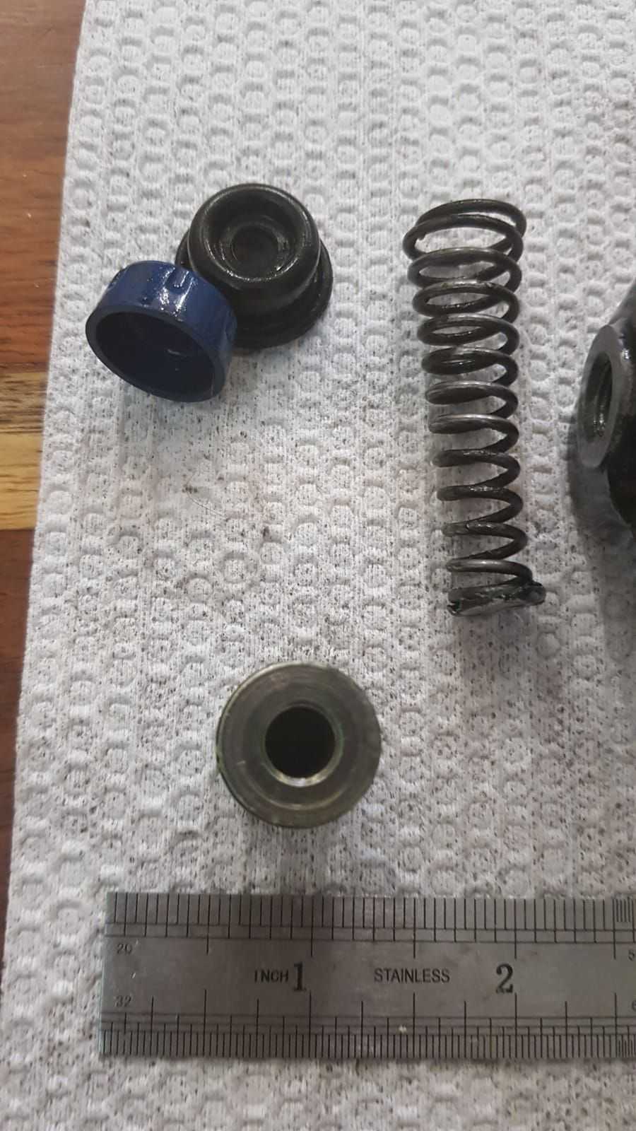

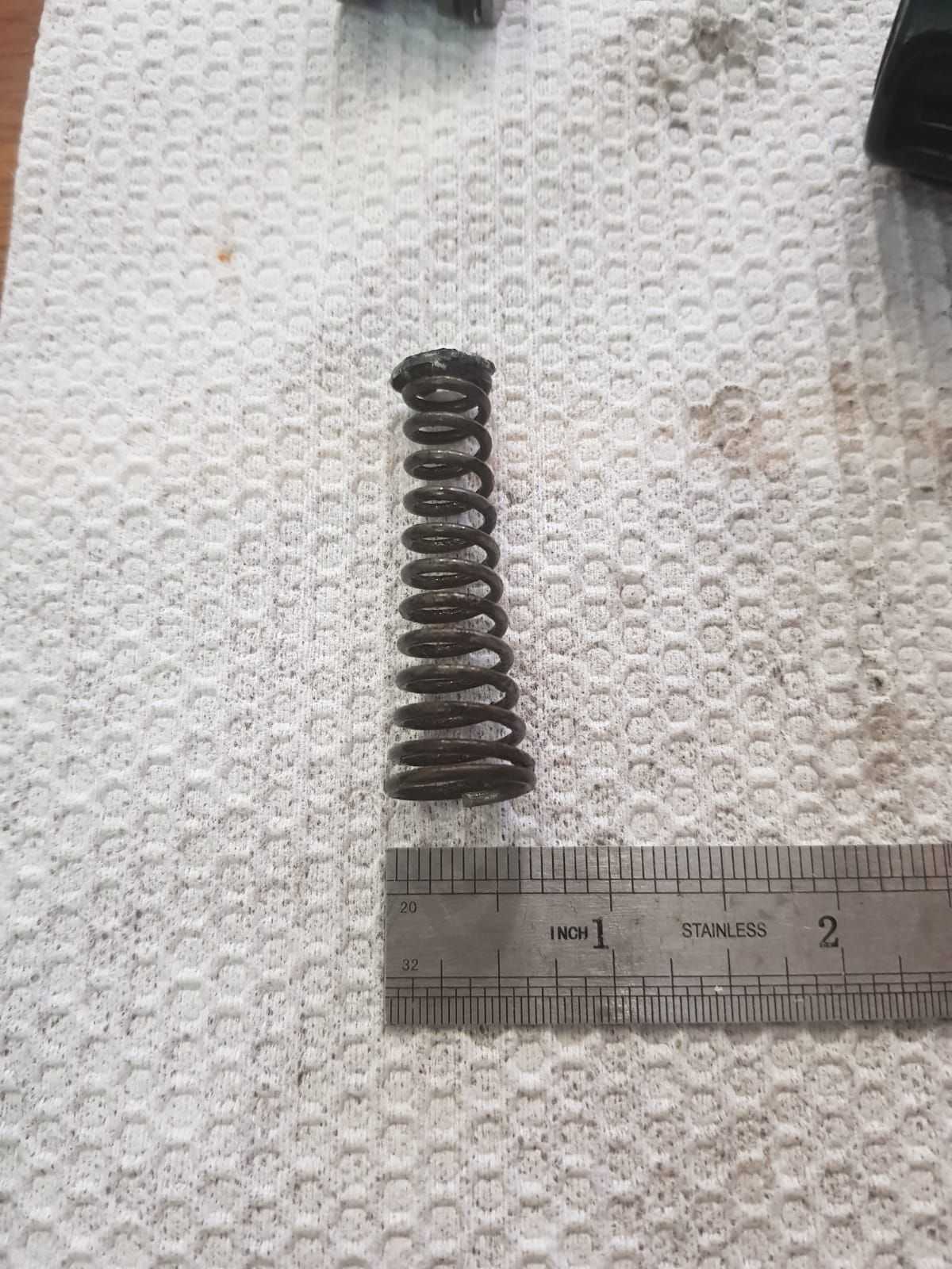

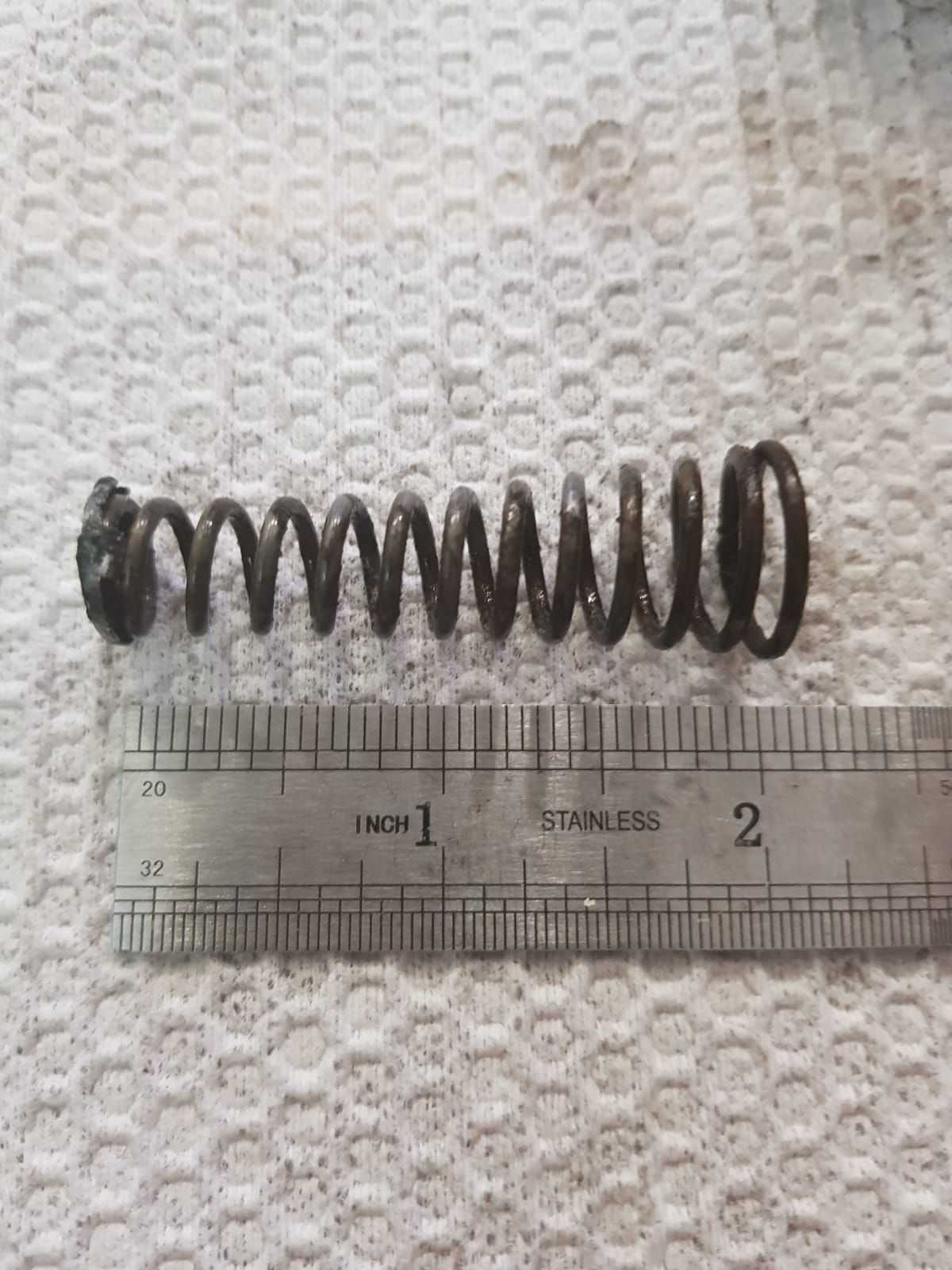

Hello.

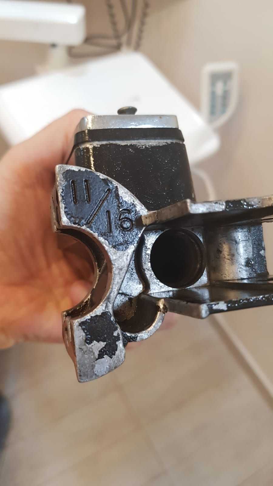

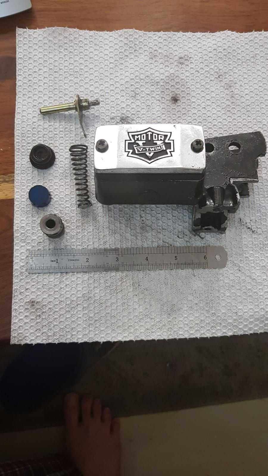

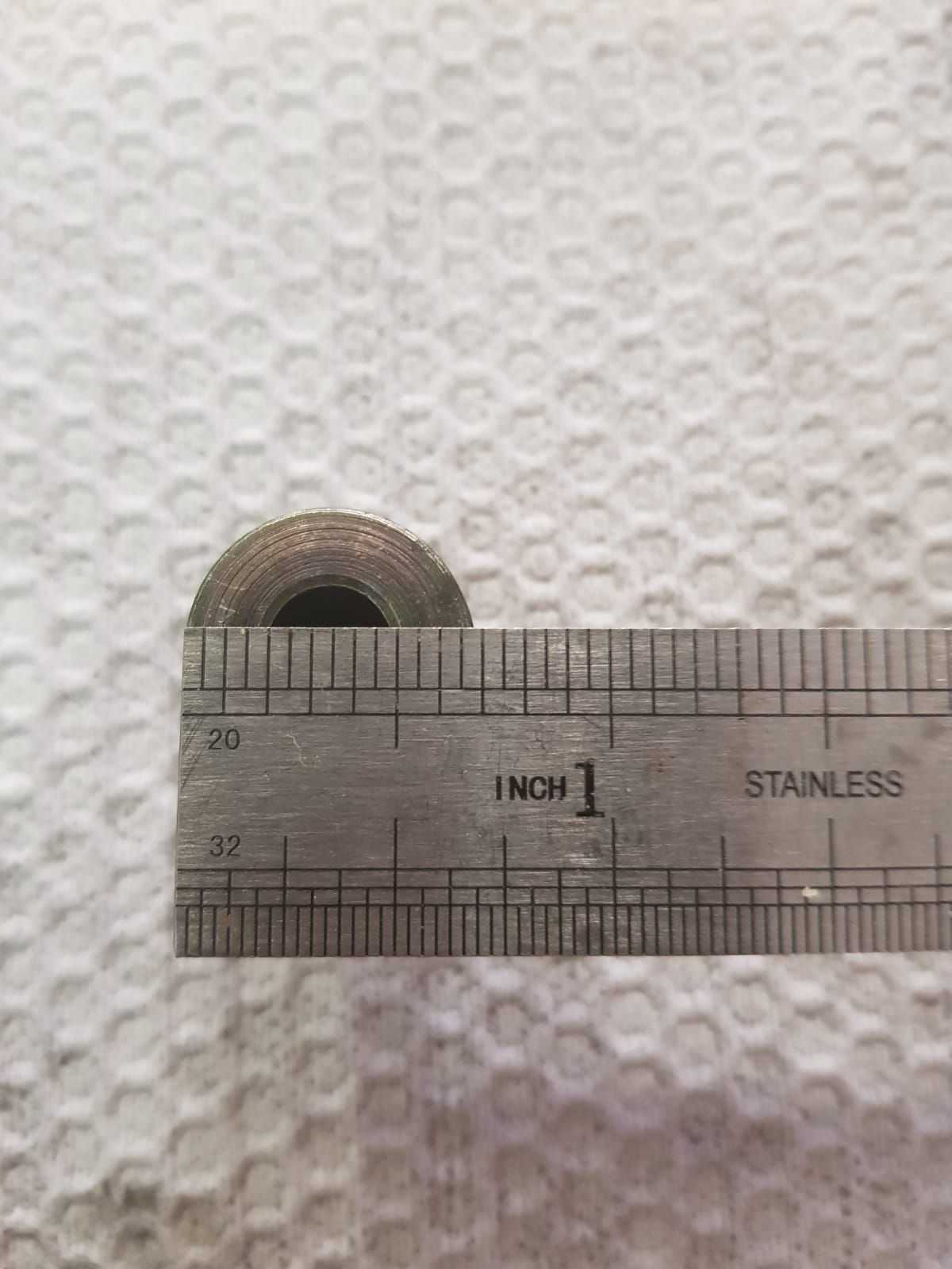

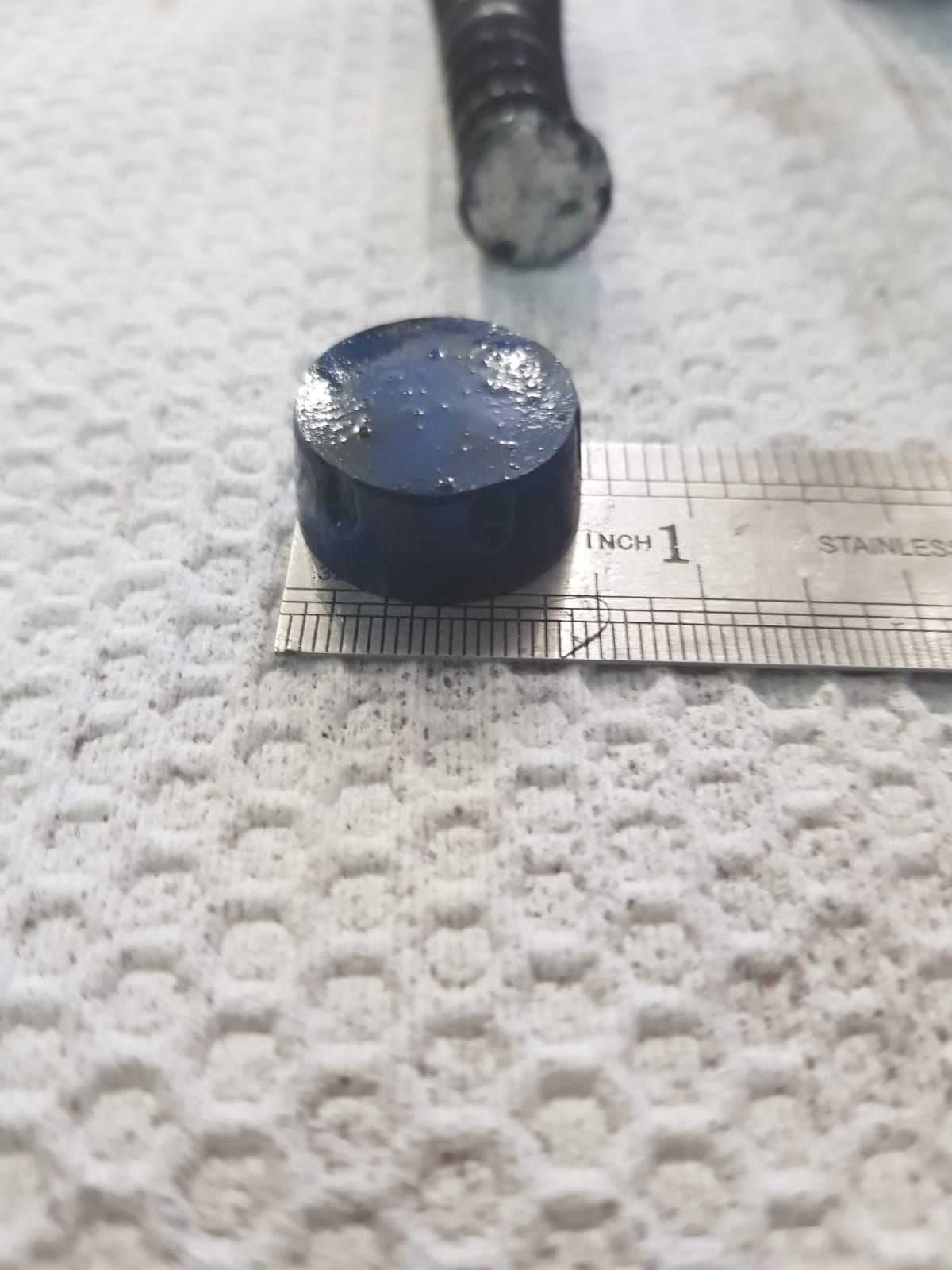

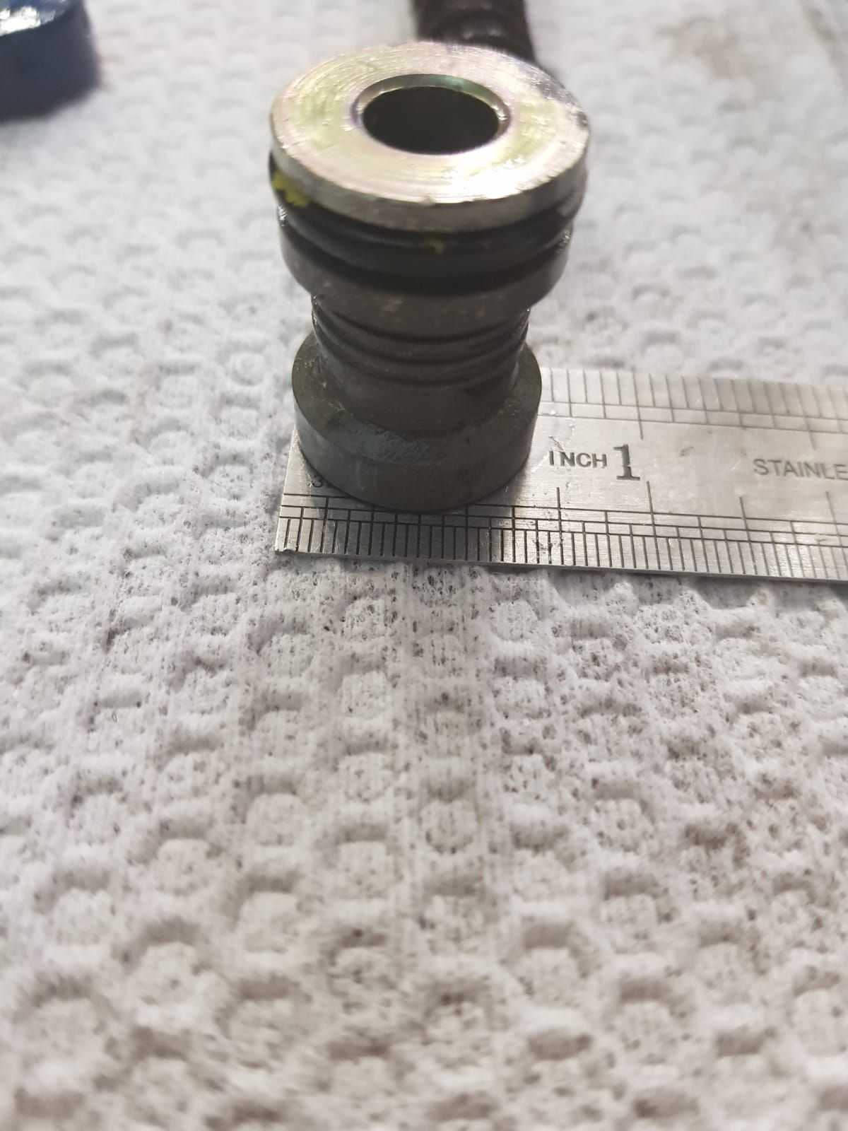

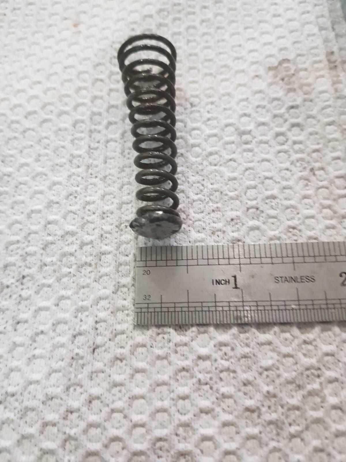

I need help with choosing the right rebuild kit for my master cylinder.In my country we don't have places to buy parts .My friend will bring it from USA but the problem is that I don't know what to buy..
I did some pictures hoping that maybe someone can recognize which kit I need?
My bike is 1985 FLTC
Thanks

You’ll need an 11/16 rebuild kit. When you receive it the piston will be one piece rather than two like the original. The kit includes the piston, plunger, o-ring, spring and lube for plunger and o-ring.

The 11/16 stamped in the end is the size bore of your MC. That's what you are matching up with the rebuild kit.

Drag Specialties 11/16 Master Cylinder rebuild kit part no. 45006-87A-PELB1 from J&P cycles $15.99 U.S. funds.

Not really. He has to buy 1995 or earler rebulit kit. 1996 and up is different.

The problem with earlier kit is that it is 3/4 .If it is somewhere earlier 6/11 kit - I'll buy it also. Where can I find it?
