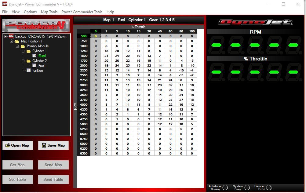

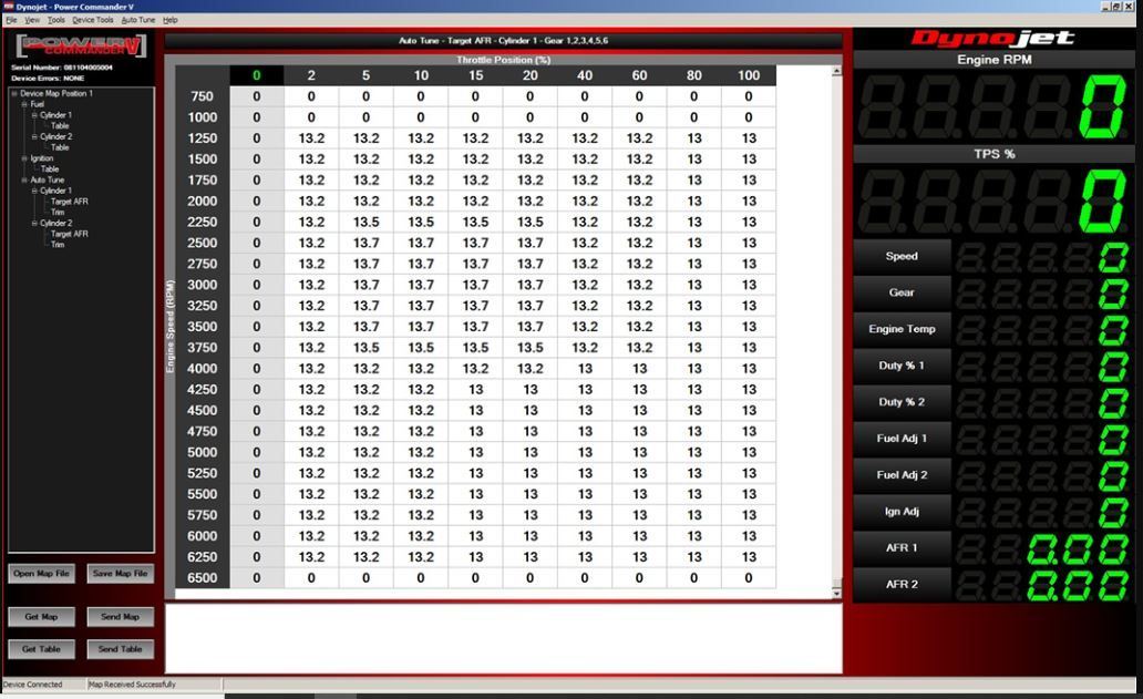

You can get the Power Commander V and their auto tuner and make your own maps as you ride. Below are the AFR's that Dynajet recommends for 1997 touring model. You load this into the PC5 autotune will adjust the fuel to keep these air/fuel ratios .
This is fuel that is being + or - to cyl #1 to maintain the AFR that you choose

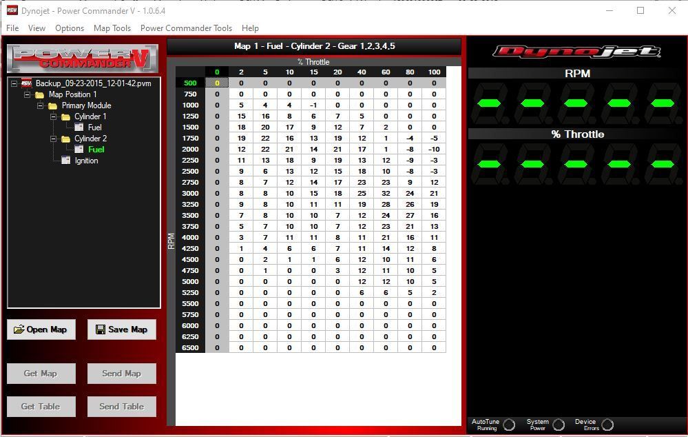

Cyl #2
