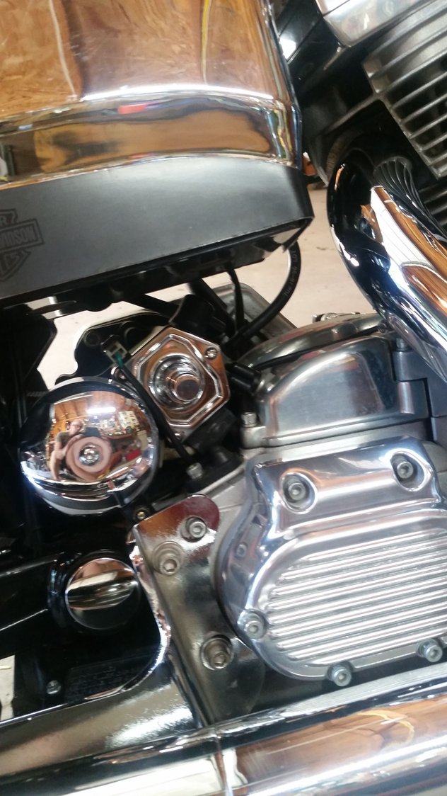

20 bucks for a push button bypass,got it on mine for a back up.
Best insurance there is! I have one on both my EVOs and wouldn't be caught without one. Takes a whole 10 minutes to install.

You have a good battery? When was the last time you replaced the solenoid contacts?
+1 on the solenoid push button.
