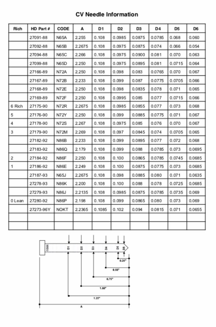

K. Lindberg's Avatar
K. Lindberg
Posts: 598
Likes: 376
From: Sweden
Default CV needles
Originally Posted by Mattbastard
I'd like to know the difference between their Velocity Needle and the N65C that is OEM on the 88 Sportster.
Here is at least the spec for the N65C.
