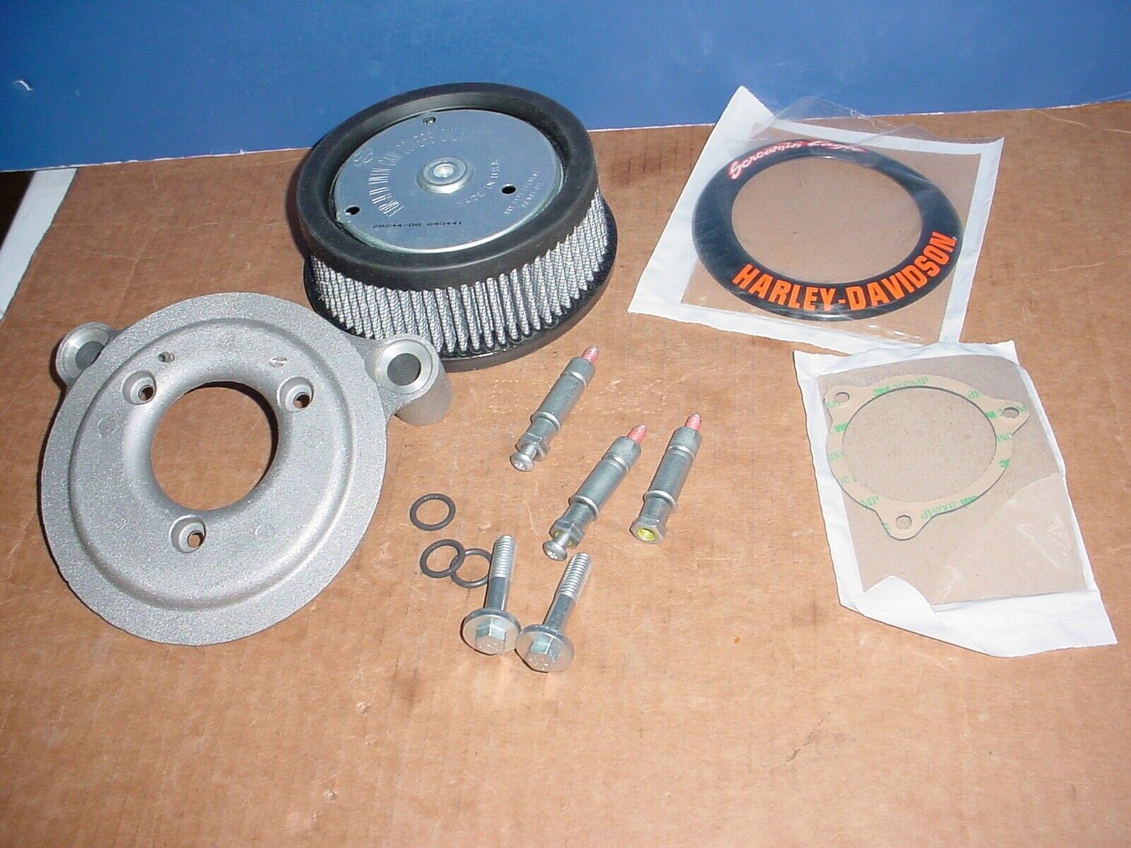

A Screamin' Eagle 40mm carburetor (p/n: 91731-85 to 91731-88) is a separate issue from just a Screamin' Eagle air filter kit ... but it was pre-1989 and the CV Kehein carb you likely have.
There was also a Screamin' Eagle Pro Big Bore 44mm CV (27934-99). I've never actually seen in one real life, but it looks the same at the stock CVK. Also a 42mm flatslide carburetor from Mikuni. There was even a 51mm CV (but god knows who needed them) and aftermarket carbs from S&S and others, so in all fairness, how were we supposed to know what you had without pictures?
So one thing you did learn from all this is each element - carb, manifold, filter etc - comes separately and is customizable separately.
Donny Peterson wrote a Bible size book about Evolutions that is very historical if you are interested in getting into them. It's not great from a performance or mechanical point of view but has lots of such data.
Here's what a similar kit would have looked like new. The chrome cover is an original stock item.
